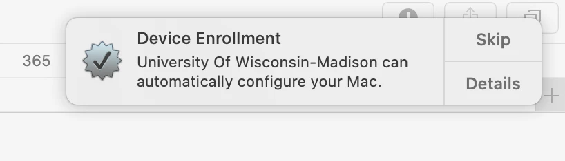

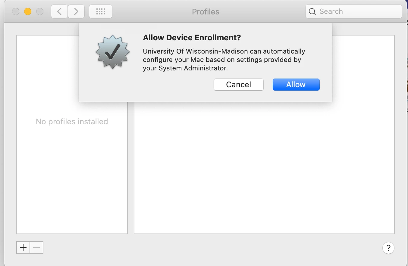

Hi, I followed adambrest's directions above to the letter and it worked - all profiles were removed. However, two strange things have happened: The Profile icon and function is no longer in System Preferences. A search in Spotlight finds Profiles and I can open it; the icon and function temporarily returns to System Preferences, but disappears again after a restart. When I manage to get Profiles to display after the Spotlight search it says I have no Profiles installed, but it should show the OS X 10.15.6 Beta profile that I installed after following adambrest's instruction. Did I do something wrong? How can I get Profiles permanently back in System Preferences?
The second oddity is that I'm still occasionally getting a device enrollment notification (see attached). How do I permanently get rid of this notification?

Sounds like you deleted all profiles while in recovery mode. If you did then it won't show 'Profiles' in Sys prefs since there aren't any.
It looks like your computer is enrolled in the University's Automated Enrollment program. That is why you are getting the pop-ups.
Who owns this computer? You or the University? If the university owns it, why would you delete all the profiles? They were installed to properly manage your computer and ensure that you have access to University applications and resources?
If this is your personal computer, you need to work with the University to remove it from their ABM account.
