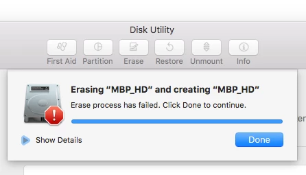

Hi folks, I'm running into a couple of strange issues with a NetBoot image created from macOS 10.12.6 (16G1408).

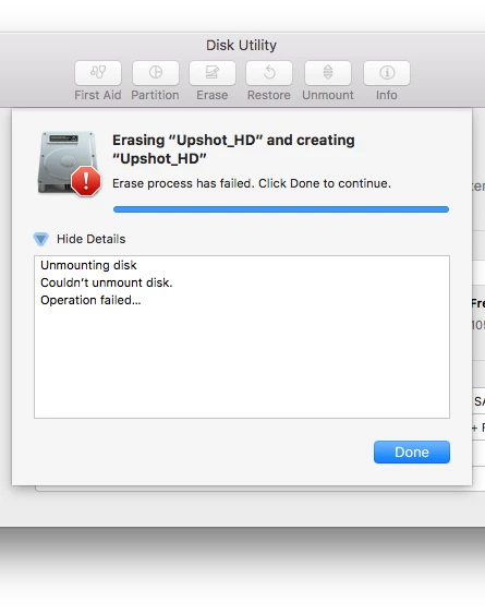

The first is that Disk Utility can't erase a disk. I keep getting errors when I try it.
When I boot the Mac with a USB boot disk, I can use Disk Utility normally. I have tried this now on three computers, and I get the same behavior.

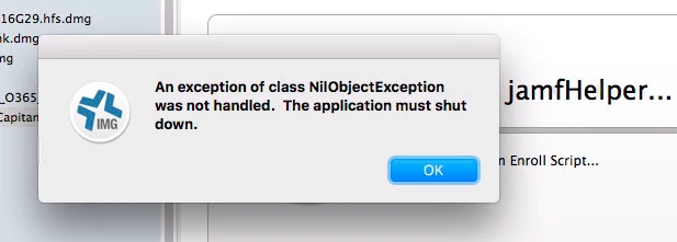

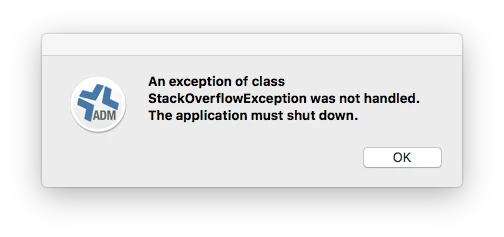

Second, if I NetBoot the computer again to image it, Casper Imaging starts its process but crashes with either of the following messages if the "Erase drive" option is checked:

Was this an APFS drive before trying to run imaging?
  • 173 replies
  • June 22, 2018
@jmahlman No, all the drives are HFS+J. When I boot these Macs with a USB stick, I can reformat the drives fine.
