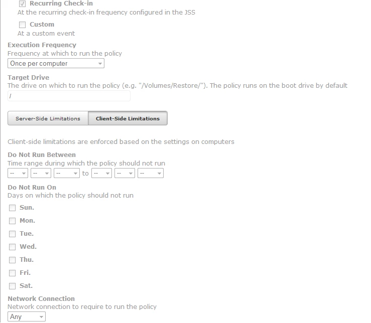

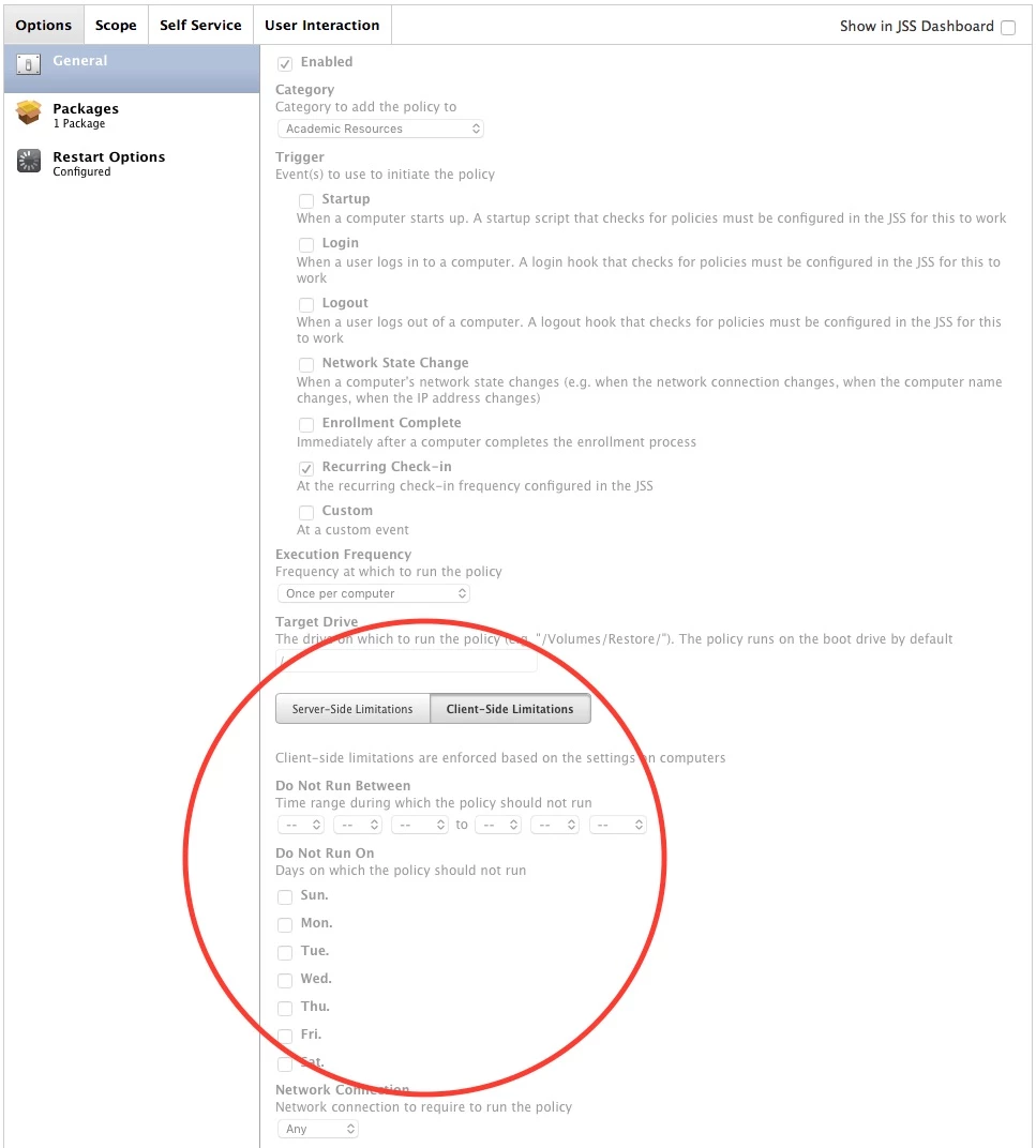

By chance, do you happen to have anything in the policies "Client-Side Limitations"? I've beat my head up against the wall a few times trying to figure out why a client was still pending before remembering that I set this.

Nothing set in client side limitations for this particular policy as you can see it just has recurring check in enabled
