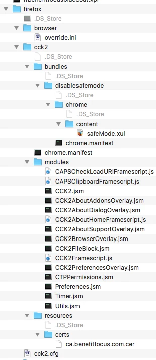

Below is a screenshot of the folders/files taken from our customized FF instance and injected into the target machine's installed instance.

  • August 10, 2016
FWIW I have no issues with CCK and ESR 45.2.0. The instructions are vague for macOS but putting the output in the following locations works. I have noted in testing this I needed to open Firefox.app once before injecting the cck2 output, code signing was pitching a fit otherwise. Was able to drop this into a pkg and install it on another machine successfully.
I have switched to the autopkgr method which has been working well but I wanted to make sure I could still get this method working.
