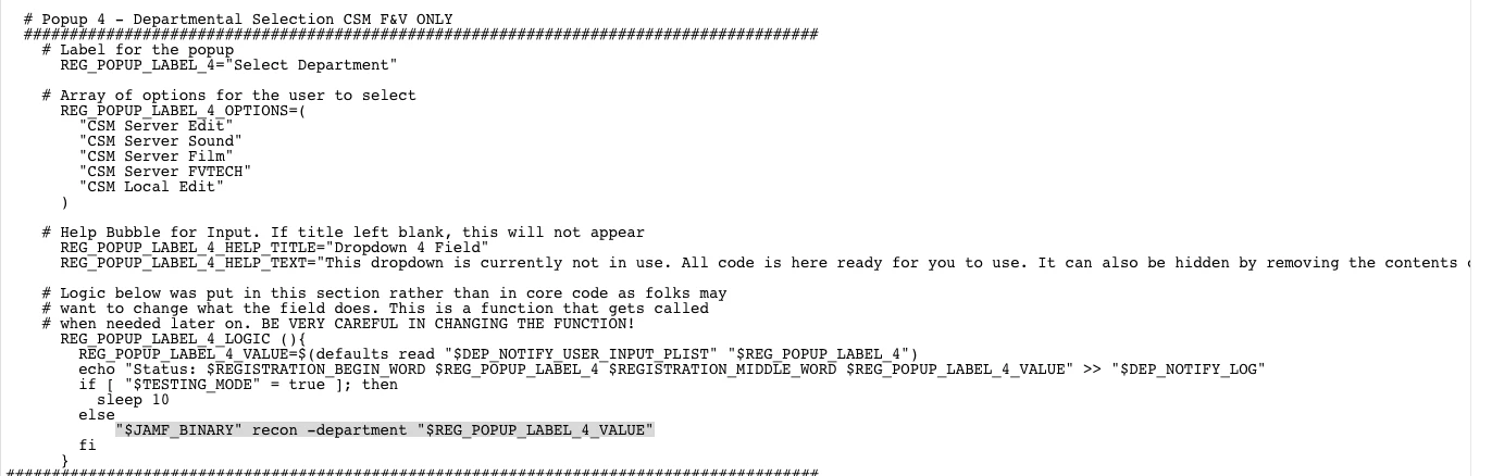

Some users would like a build with no software applied, relying completely on self-service. Other users would like us to install commonly required apps, such as Office, Chrome, central print queues, etc. That's essentially two different builds, and I'd like both to be selectable through DEP Notify, if possible. I.e. a drop down box or equivalent and depending on their choice, they get software or don't.

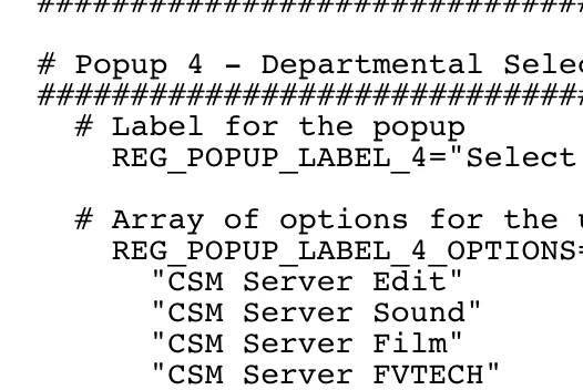

Yep, once you have scoped policy (I do it via department) you can add to this part of the depnotify script
There will then be a popup dialog field which can be selected from the Depnotify screen.

So,
Create a Prestage Enrollment
Create a Smart group based on that
Create Depnotify Script with ALL applications in the 'policy Array"
Add 'core only" and "Full Image" to Popup4 in the script.
If not present- Add the line "$JAMF_BINARY" recon -department "$REG_POPUP_LABEL_4_VALUE" (with the quotes") at the end of popup 4 (see attachment)
This will write back to the JSS and populate the 'Department' field
create a policy scoped to that smart group which installs Depnotify App and the Depnotify Script (Ensure script is set to . Priority "After"
Scope all policies to this Department i.e "full Image"
So, when DEpnotify runs and you choose from the popup, only the policies scoped to the particular department will be installed and the others skipped.
