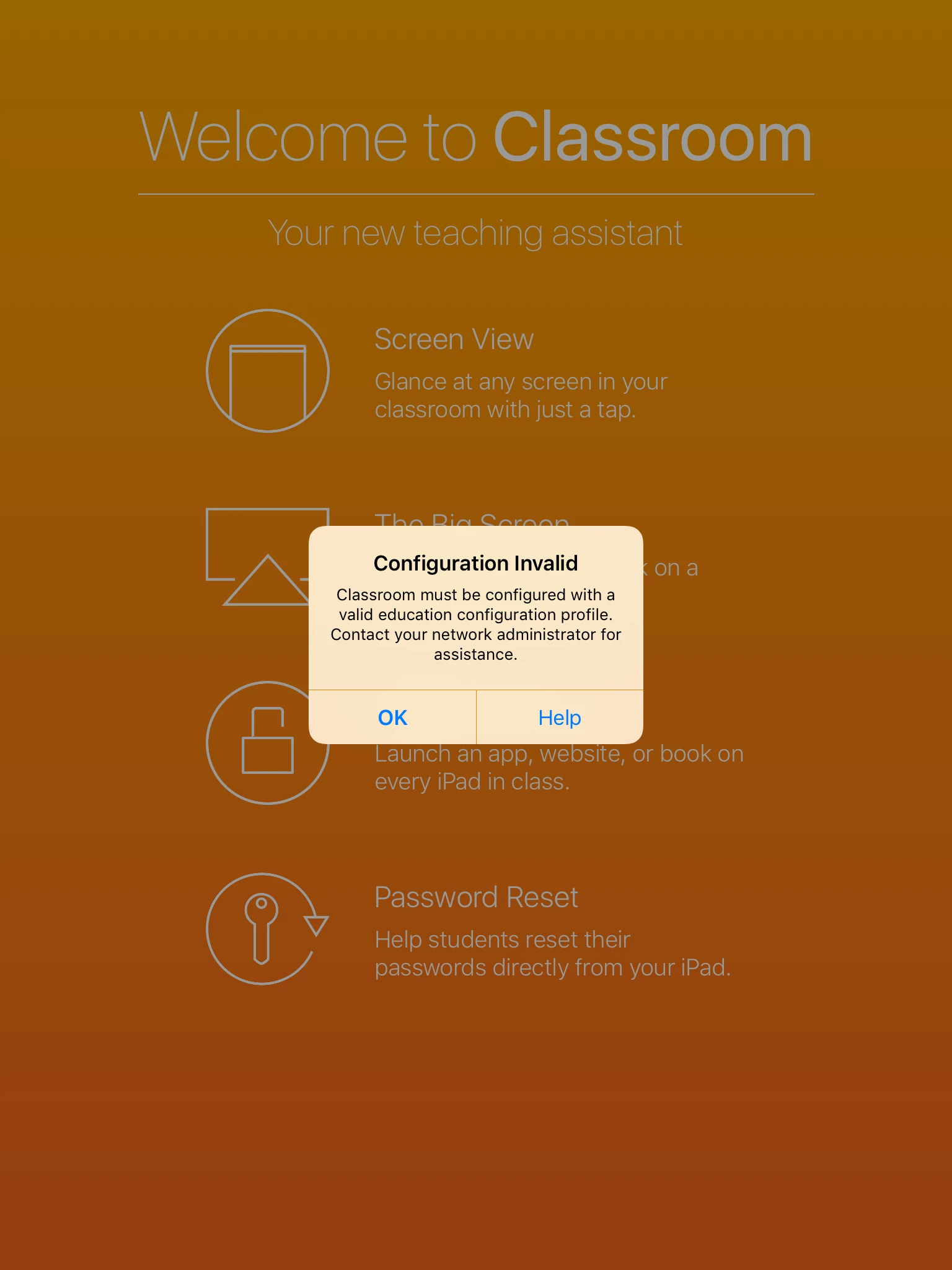

I currently have a ticket open with JAMF, but I wanted to reach out to the community to see if anyone else is seeing this issue that our environment is seeing:
Is anyone else getting the error message of
I have verified that both the teacher and student device is on:
iOS 9.3 or higher
Bluetooth is enabled
Device is Managed and Supervised
EDU Configuration profile has been installed on both teacher and student iPads.
When I tried to navigate to the EDU Configuration Profile on both devices via: Settings>General>Device Management>MDM Profile
The iPad crashed to the springboard.
I connected the iPad to iOS Console on Mac and ran through the above steps to capture a log file. When I launched the Apple Classroom App, the log file indicated that the “Provided configuration was invalid”
10 07:26:02 DMPMMTBEFK10 Classroom[312] <Notice>: (Error) <CRPreflightViewController.m -[CRPreflightViewController writeConfigOperationDidFinish:]:174> Failed to write configuration with error: NSError: 0x154e7d710
Desc : The provided configuration was invalid.
When I went into the MDM Configuration Profile, the log file indicated that “Object cannot be null”
May 10 07:26:43 DMPMMTBEFK10 Preferences[313] <Error>: Terminating app due to uncaught exception 'NSInvalidArgumentException', reason: ' -[__NSArrayM insertObject:atIndex:]: object cannot be null'

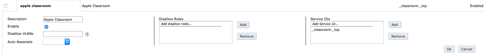

@edullum it is P2P protocol that is blocked on our network, so we had to make an exception for it. I understand that it is supposed to all happen bluetooth, however, without that exception it would not work in our environment. We passed that along to the Apple folks early on, things may have changed. (I am still not removing the exception, "if it ain't broke...")
@wdpickle I'm going to implement that on one of our WAPs to see if it works. Did you just create that service, or did you make any other adjustments in Aruba? Did you enable sharing or did you just add the service?
We created it. We basically copied the set up for air play and called it apple classroom.
I looked it up and took a screen shot of the config. Really nothing to it (for us)
We mirrored that setup and it still doesn't work :(
