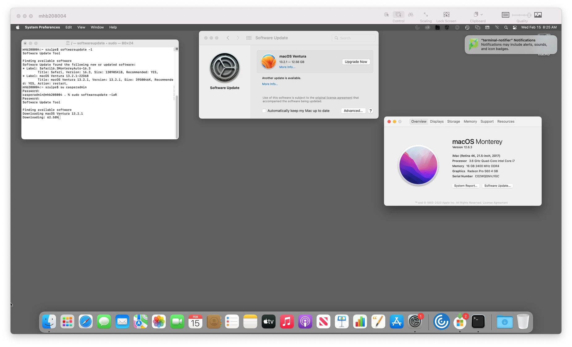

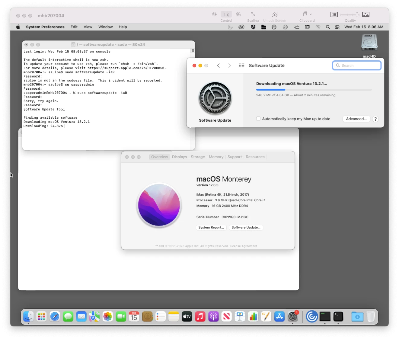

So i have noticed that over the last few weeks my 12.6.2 and 12.6.3 machines are getting the macOS Ventura Delta update not upgrade anymore.
Is this correct?
I found this when running my weekly softwareupdate -iaR command on my classrooms/labs machines to keep them patched.
According to Appel an Jamf this should not be happening.  Did Appel release yet another bug? Or is this intended behavior and if ti is intended why only some of the machiens are doign this vs all of them in scope of my policy?
While troubleshooting i ran this on a machine manually in terminal and it did it.  I forgot to check what the Software Update Pref pane showed before i started, will check a few more machines.

szultzie
  • Feb 15, 2023 1:43 PM UTC
Found another one, clearly it shows the upgrade in Software Updates, but the command is installing Ventura.  Couldn't catch to see how big the download was, it went awya pretty quick.

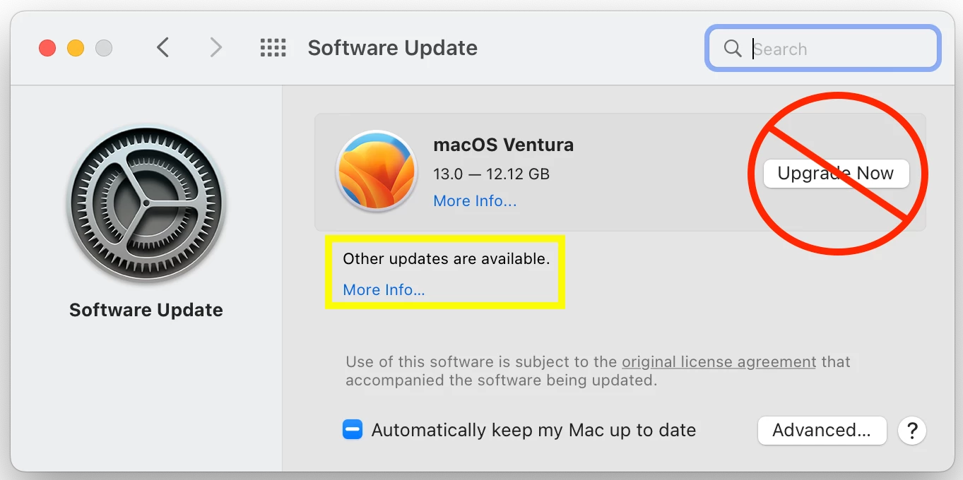

Delta updates are a sneaky way of pushing users onto Ventura, but we've shared the following annotated screenshot with end-users in all communications:
