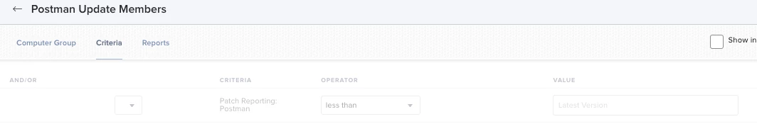

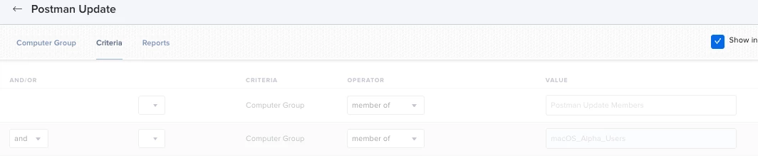

I’m trying to create one policy that will deploy 3rd party updates using the current smart groups we’ve created. From the few different test’s, I’ve down, I can’t seem to get it to work, I still have to go in and add/remove test groups.  The below steps and screenshots are how we currently do it. We have to control the majority of the software updates; we aren’t allowed to just set so they always update except for some developer apps that update a lot.
  1. We create 2 smart groups for each application like the Postman one below and depending on the test group, will add in either alpha, beta or uat
  2. I then have a policy for each software, I have it set to recurring check in, set to ongoing and then set our deployment date/time each month and use the specific software update update computer group
  3. When the software updates, the device will drop out of the smart group, so it won’t keep installing. That way I don’t have to go in to the device to flush the policy each time
  4. We don’t have a ton of apps, but trying to see if I can cut some of this process down a little, so I don’t have to go to the 2nd smart group to add the next tester group or remove the prior one.
