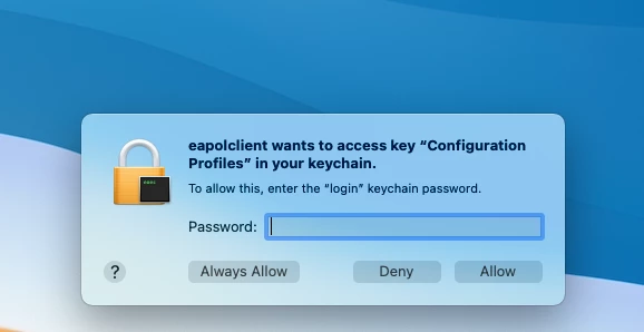

Our 802.1x network has been working for more then a years, but again and again I have seen the isse, where users first time they connect got the attached image. The user certificate is located in the users login keychain - I don´t know if that has anything to do with it
We use network payload - and just asking me if this somehow can be stopped so this popup will not appear anymore.

  • May 27, 2021 10:43 AM UTC
Actually I also have this issue - quite annoying. Anyone know if this is possible to solve?
  • Jun 9, 2021 11:06 PM UTC
Seconded... having the same exact popup for a first time login. Did you all sort anything out?

I've just been banging my head against this one, too. However, I have found that it only seems to happen when the “Remember this information” box is ticked.
For this example, it's a Wi-Fi connection.
— Connect > Select Certificate > Untick “Remember this information”: No prompt
— Connect > Select Certificate > “Remember this information” ticked by default: Prompted
It makes sense, I suppose. It's trying to write that back to something in the system keychain where a standard user doesn't have permissions. Manually marking the certificates as “Always Trust” makes no difference.
Despite not selecting to remember, it seems to.
