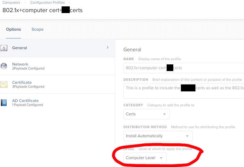

  • Oct 29, 2018 4:33 PM UTC
We're also using 802.1x with trusted certs and I have the config profile set to Computer Level. it works just fine. One difference is that we are not on Mojave yet. But this configuration has been working in every version since Mavericks.
  • Oct 29, 2018 6:50 PM UTC
Thanks for the response. My profile is already set to computer level and my network payload is also delivered with our cert stack. I was unable to get the workflow the way I wanted it with the AD Cert since machine has to be domain bound before the AD cert would apply so I have it deployed separate. Do you mind me asking how your network payload is setup?

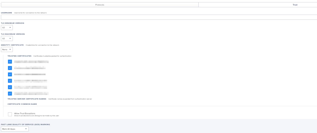

  • Oct 30, 2018 10:53 AM UTC
Thanks AVmcclint,thanks for clarifying that. Do you mind sharing what your 802.1x network payload looks like? I'm wondering if you have an identity certificate selected in your profile. We were unable to get that to work correctly. It seems like the key to getting the machine to be present on the network pre-login is within that network payload and network authentication.
AVmcclint
Forum|alt.badge.img+21
  • Oct 30, 2018 11:01 AM UTC
I have the AD Certificate selected as the identity certificate since that's what our network requires. Your particular AD Certificate setup will depend on your server's requirements, but once you get that setup then everything else should fall into place. If your network requires a different cert then I would have to imagine you'd have to provide that in a different manner.

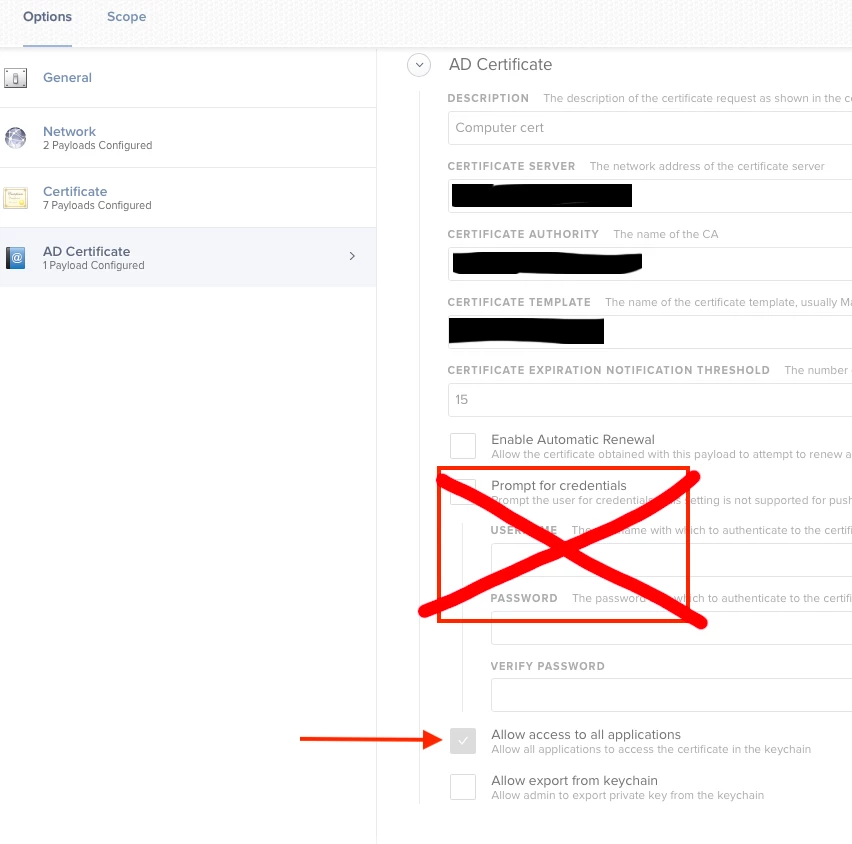

@stutz I've never heard of that kind of behavior. I have noticed that the exact behavior may depend on your particular 802.1x infrastructure. We recently changed from Juniper to Cisco with some 3rd party access control system (since my first reply on this thread). Even though the configurations on the computers has not changed, the user experience has changed. Under the Juniper setup, both Ethernet and Wifi just worked. Period. There was no prompting for certs or admin credentials once it was setup. Under this new system we have, if a computer is plugged into Ethernet at the time the user logs in, they will be prompted to pick a cert... they pick the correct cert.... then they are prompted again ad nauseum and it never seems to fully connect. If the user unplugs ethernet and waits a few seconds before plugging it back in, it will connect with no fuss. I've been telling users to wait until after they are logged in and at the desktop before connecting to ethernet.
I used to think 802.1x was 802.1x. This experience has opened my eyes to a whole new reality. Unfortunately I'm not knowledgeable enough about networking to fully understand what's at play. As long as you have your config profile set to AutoJoin, in theory, you should be OK. But I'm willing to bet there may be some settings on the 802.1x controller side that may need to be massaged to smooth things out.
The only other thing I can think of is to make sure your AD Cert payload is not set to prompt for credentials and do allow access to all applications. (checking the box for Automatic Renewal may also be a good idea. This was a recent addition but i've been handling it with a shell command)
stutz
  • Apr 26, 2019 5:39 PM UTC
@AVmcclint
Thanks for the response. I checked the profile and those areas were already set to your suggestions. I'm thinking it has to do with our network settings as you also suggested because if I strip the Ethernet settings from the configuration profile I can connect to WiFi without having to enter admin credentials or select a device certificate and it works on the login screen.

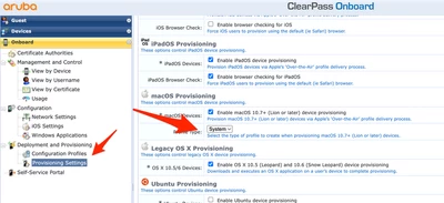

Hi,
We use Aruba brand Access Points in our WIFI network. 802.1x is used to connect to the network through these products and we include users in the network by verifying with a certificate. At this stage, identity and certificate verification is done with an application called ClearPass. The ClearPass application also serves as an MDM server and SCEP server. When we connect to Access Points, the ClearPass application sends a profile file to users via a web interface. Actually the whole solution is contained in this profile file settings. We changed the part specified as "user" in the settings of this configuration profile file, sent to MacOS devices by the ClearPass application, to "system". Thus, as soon as our MacOS device was turned on, the user was able to connect to the network automatically without logging in. If the application you use is ClearPass, I support this article with screenshots. You can use the screenshot below. After making this change, you need to delete and reinstall the WIFI profile on the macOS device. After this step, the problem disappears.

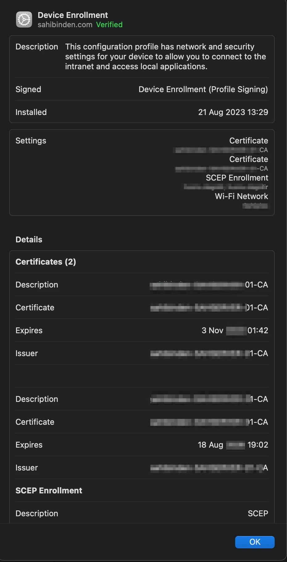

Hi @wifichallenges
To connect automatically, you need to download a profile to your device. During the onboarding process, Clearpass should send you a configuration profile file and you should install it as well. Are you doing this? I am adding the contents of the profile file. By the way, Clearpass is supposed to work like a SCEP server. It would be easier to do this with a company from which you get consultancy regarding Aruba. In the posts I published above, I also explained what to do for the profile file.
