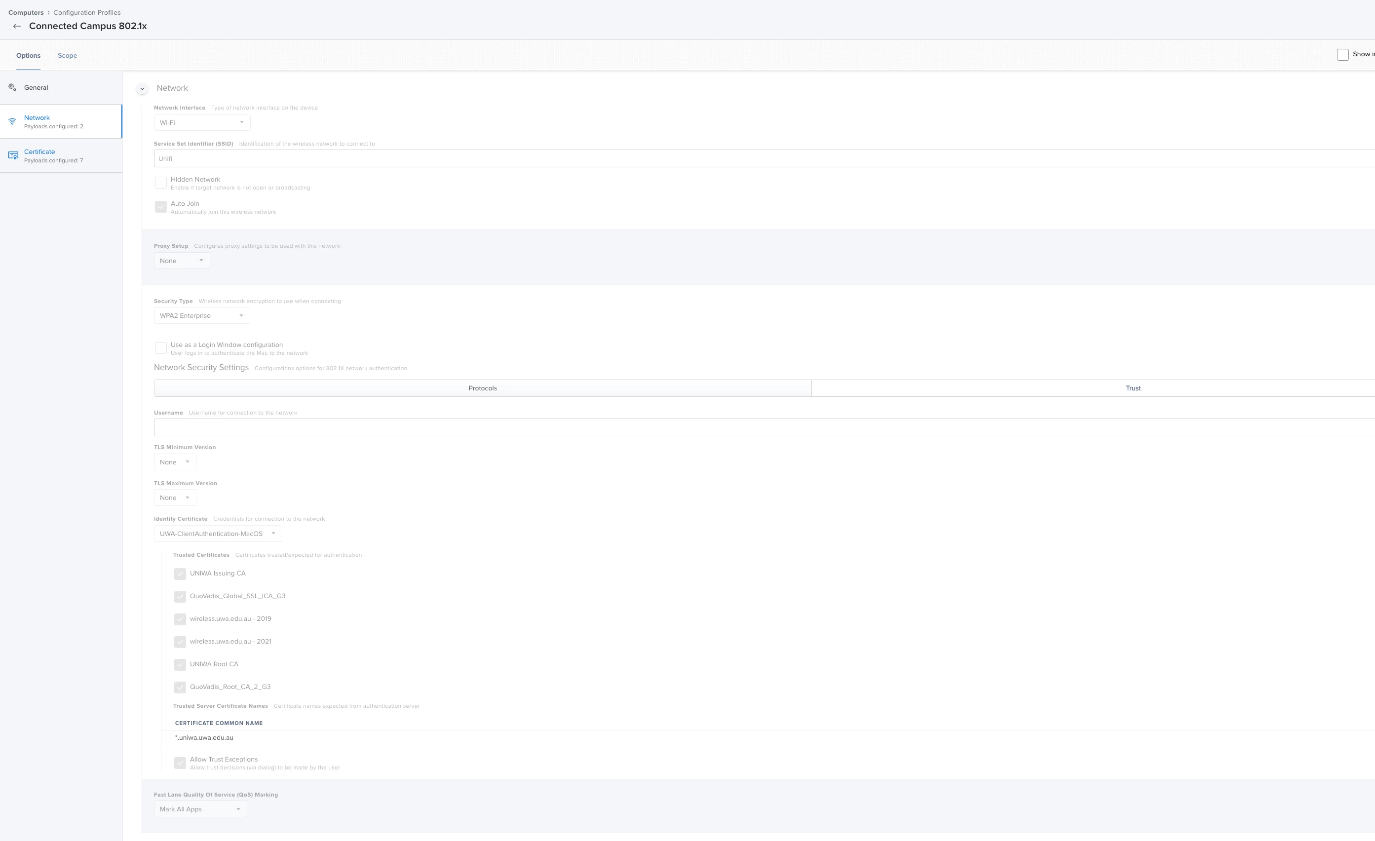

Hey there,

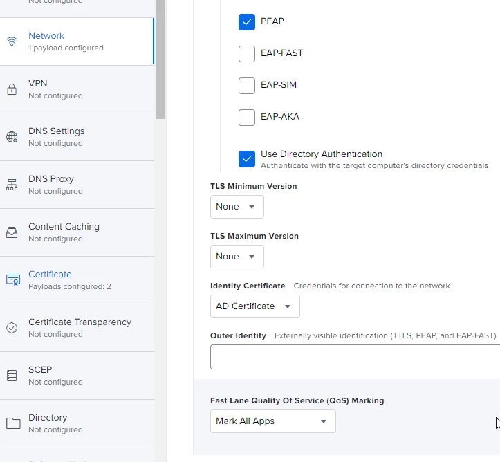

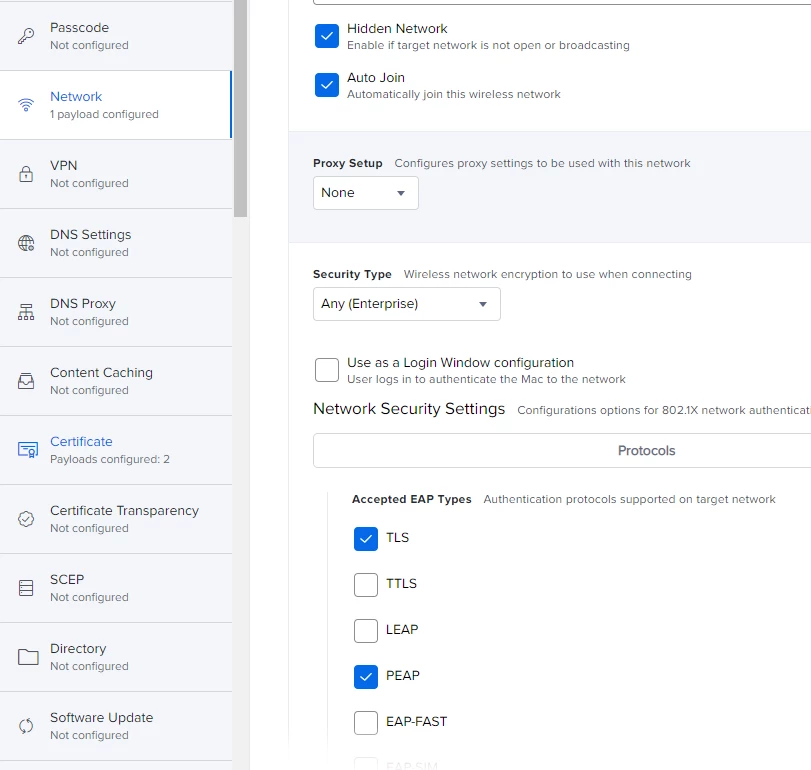

I am trying to get the mac laptops to use certificate based logons for 802.1x. The machine can join to the AD domain, it can generate a certificate and i see that certificate on the machine. However when i try and apply a jamf profile to add the certificate and wireless profile to connect to the network i get the following errors:
mschap: FAILED: No NT/LM-Password. Cannot perform authentication
Login incorrect (eap: Failed continuing EAP TTLS (21) session. EAP sub-module failed): [MS\\lmc02d<FULLHOSTNAMEREMOVED>
I have tried with PEAP as well as TTLS. On the windows laptops i have connecting using the same infrastructure, they connect fine and do not require any password. What is the point of certificate based logons that require a password? Makes no sense. But jamf / macs appear to need something there. Its very possible my jamf config is the problem here.
The domain root certificate is SHA-256, and is added to the same profile and trusted on the trust tab. I also put in the names of the radius server and the CA, and allowed trust exceptions.
I have tried all the different auth protocols and the error message changes, but the results are the same.

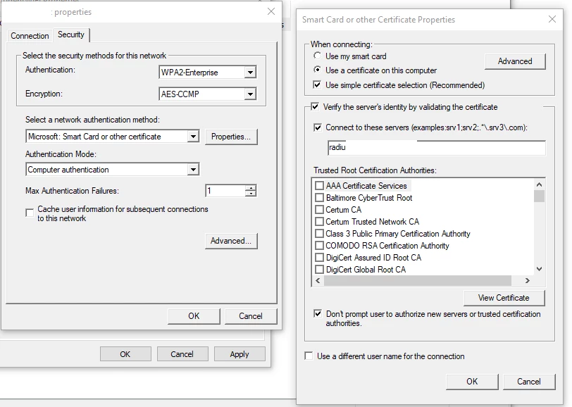

I have included the windows settings from group policy that do work without issue.

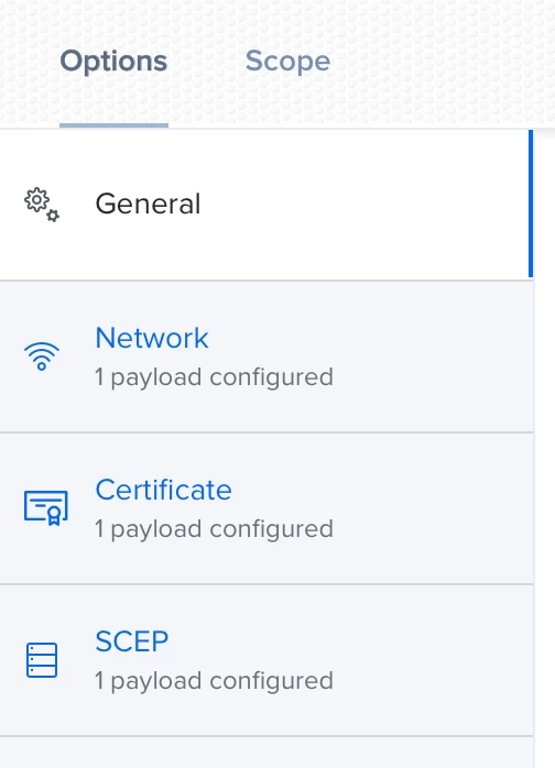

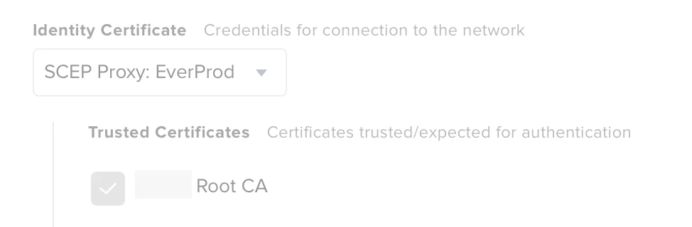

I would suggest using an ADCS cert or SCEP certificate to do this. You can hop over to the 802.1X MacAdmins slack channel if you need more references.

Hello WifiChallenges,
You need to add Root CA in the profile and also add Trust to root CA in Network payload in the same configuration.

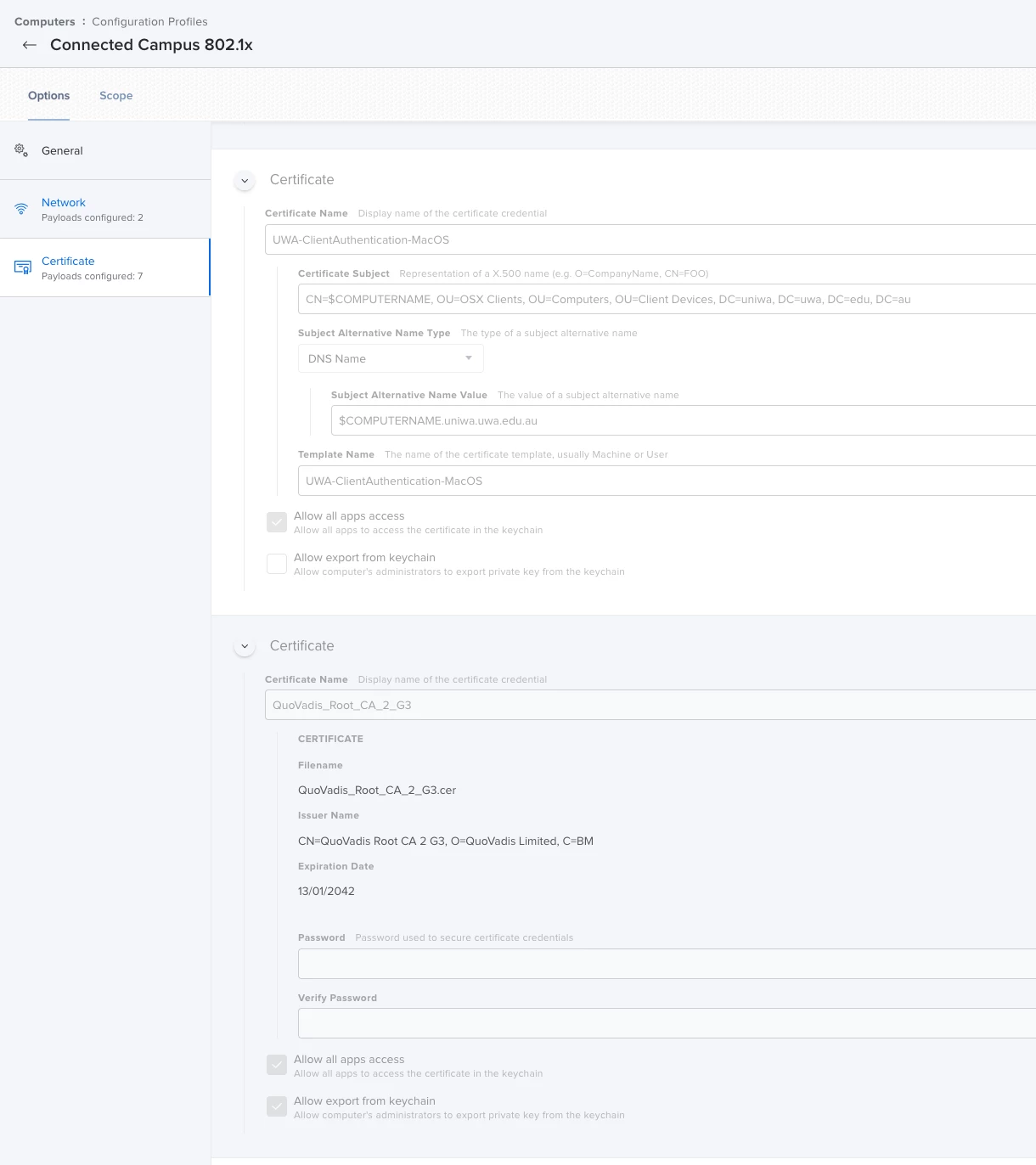

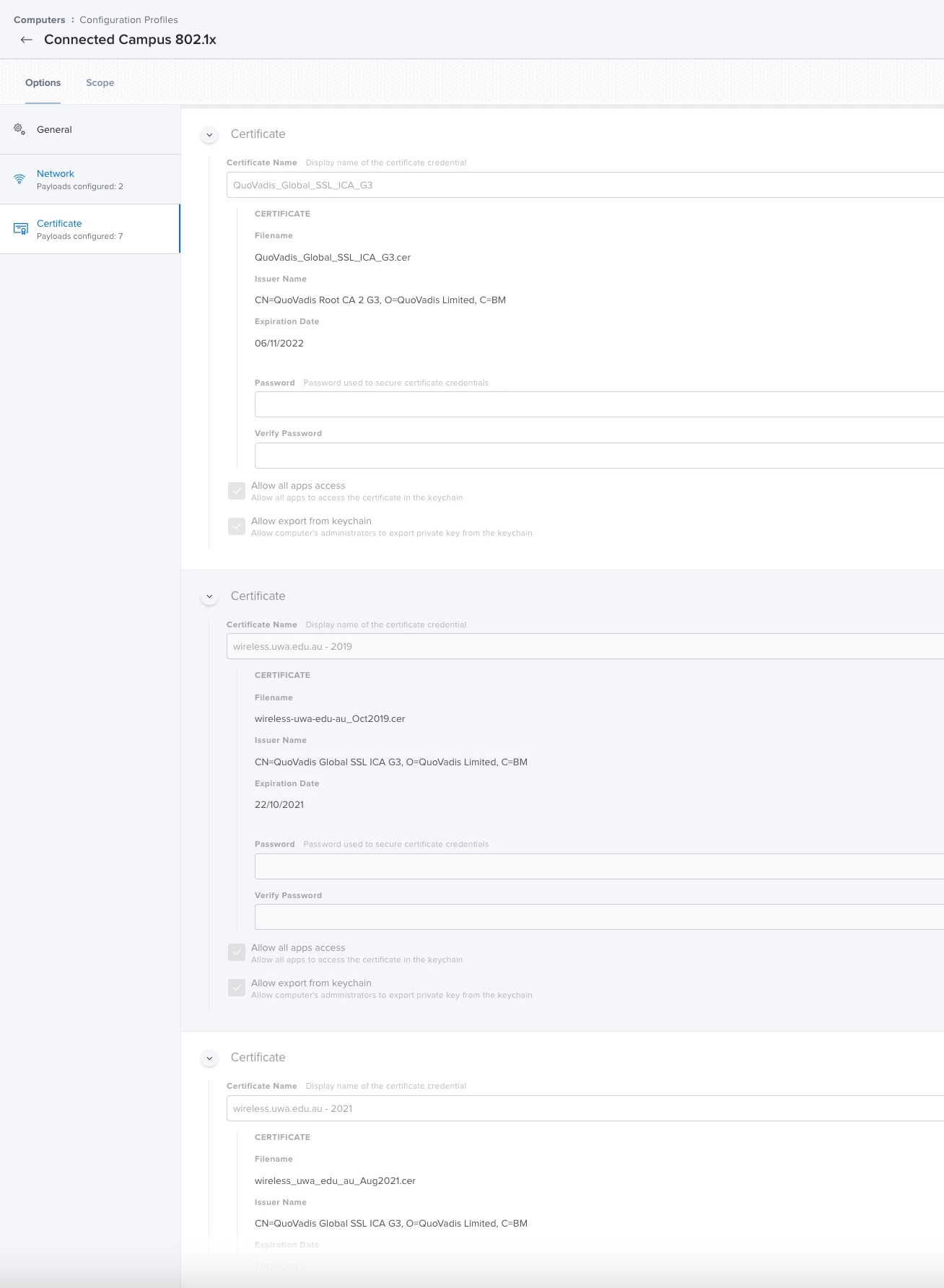

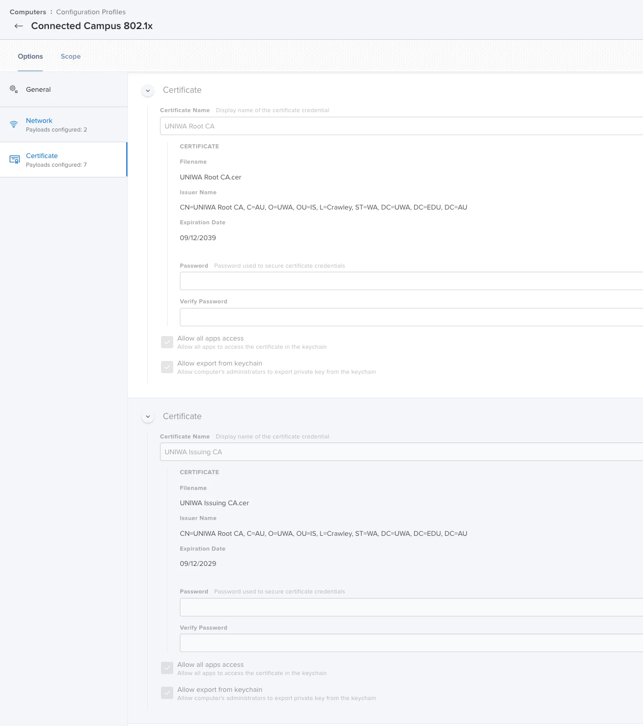

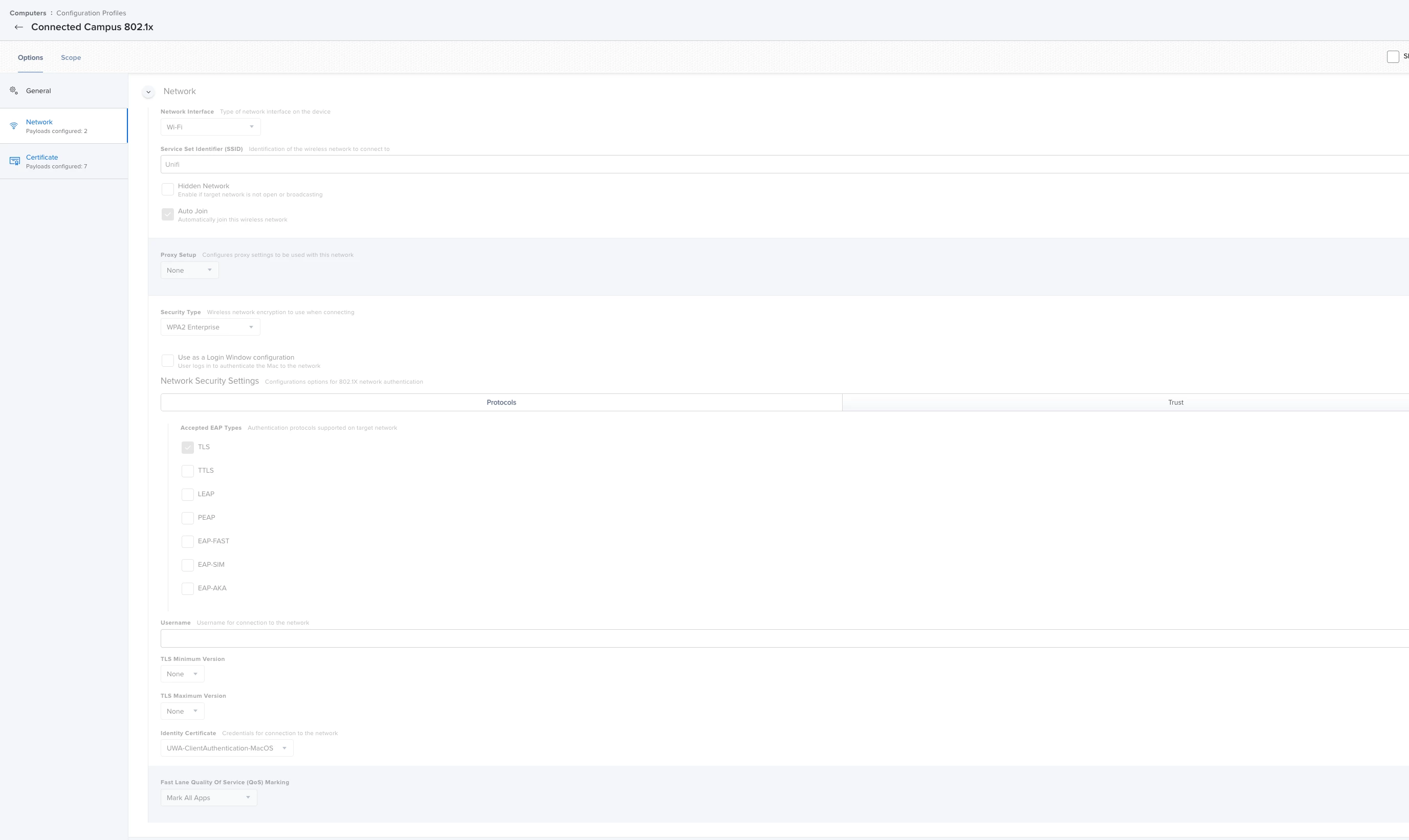

I have this working with a Configuration Profile that gets a cert via ADCS.  There is a lot more in my profile than yours as I found separating it out into each part e.g. machine cert, root cert etc was a big fail.  I didn't figure it all out myself - my friends in the Network Team helped big time telling me what the Radius server was objecting to as well as our Jamf Success Manager pointed me skillfully in the right direction.
Maybe these screen shots will help ...

Thanks for those images. That is interesting how you have $COMPUTERNAME in there.... Do you have this AD CS connector installed in your environment?

Hi @wifichallenges - Yes that's a working setup I showed you.  $COMPUTERNAME gets replaced in the certificate with the machine name that is in scope.  I found I needed all the certificates shown - even the wireless cert.  This way there are no prompts about trusting certificates and the machine connects before anyone logs in.  I needed the AD CA and AD ICA as well as for us the Quovadis CA and ICA certs.  I know on Windows that is not needed but it was for the Mac's.
Yes we are using ADCS Connector to get the device certs
