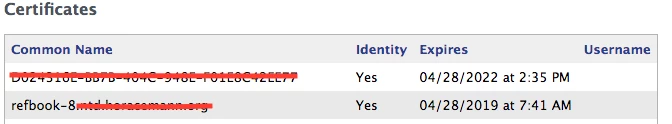

From my own university, we have recently started looking into 802.1x and we were failing to get machine certificates.
Verify you are getting those first. If not, it is possible that the ICertPassage protocol is disabled on the certificate authority.
Once we enabled this with certutil.exe, the machines would then get the proper certificates to be used at the computer level with 802.1x via configuration profile.
I also think but am not sure that the AD Certificate payload and the network settings payload have to be in the same profile. I might be wrong on that however.
