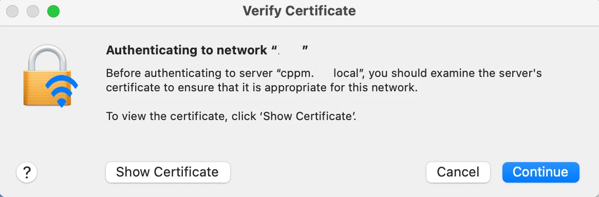

Three months ago, we updated our RADIUS certificate. During this process, we chose not to push the RADIUS certificate through Jamf because our WPA Enterprise setup uses Active Directory account credentials (rather than static accounts) for authentication.
With this setup, each user logs into Wi-Fi individually. After the RADIUS certificate change, Mac users encountered a pop-up upon connecting to Wi-Fi,
prompting them to continue and enter their MacBook login password to reconnect to the internet. However, users connecting via LAN cable were unaffected and did not see any pop-up.
then after that you can schedule to delete the expired cppm cert manually in Keychain Access.
