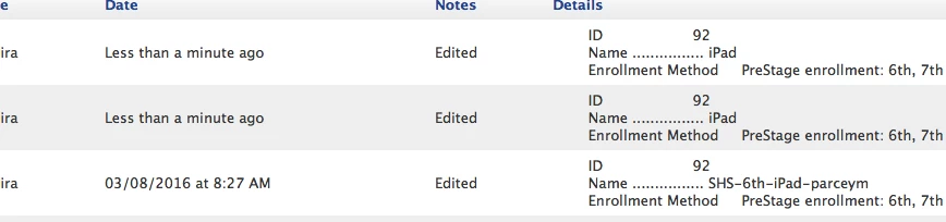

I'm still having issues with this... I did notice in the configuration profile that I did have the option checked to dissallow students from changing the name. I have updated the configuration and pushed it back out.
For the few iPads that are named "iPad" I have gone back into it to edit its general name so that it will get set to what I want it to be, but it does not seem to be saving. When I look at the history even after I click save it stays as "iPad". Screen shot attached of the history of this iPad.
Very confusing. Anybody else still seeing this issue?
