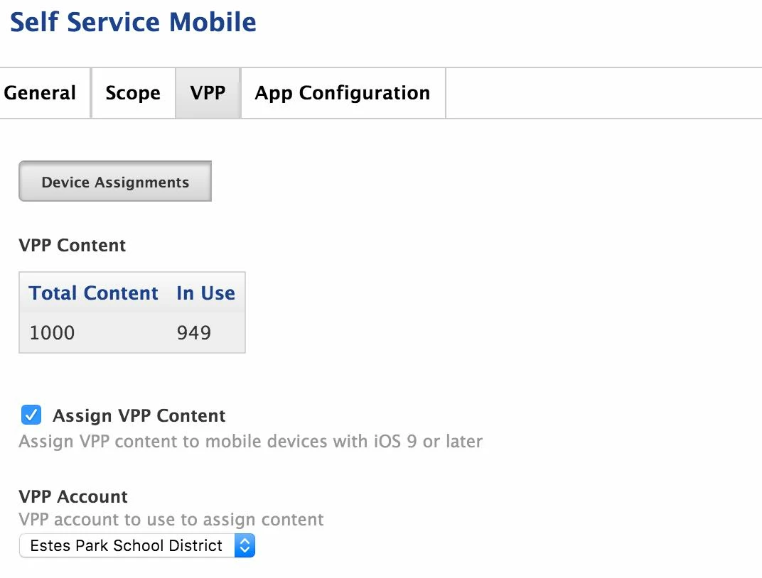

Under the app self service click the vpp tab and check the box "Assign VPP Content." That should make it assigned to the device and not require an Apple ID.

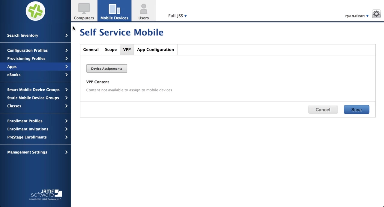

@Nick_Gooch here is what I see when I go there.
Nick_Gooch
  • October 5, 2015
@ryan.dean Are you using sites? I saw the same thing and as soon as I removed the app from the site and set it to none it allowed me to check the box.

@wdpickle My profiles and web clips are sending just fine, and the apps themselves are pushing to the device, just not utilizing the feature where they install without Apple ID. I've done everything suggested, not sure what else to try.
@Nick_Gooch I was using a site on my VPP account, and the app I added was not in a site. After I changed my VPP account to no site, I was able to see the check box, thank you for you help!
