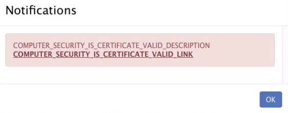

I installed 9.98 on a test box, upgrading from 9.97.188824529405205225425r9243u5r0234, a notification alert was waiting..
It links to Settings --> Computer management --> Security...
But doesn't list anything is specifically wrong.

@jwojda Have a look at this
ImAMacGuy
Forum|alt.badge.img+23
  • March 22, 2017
oh, that worked, thanks @bentoms

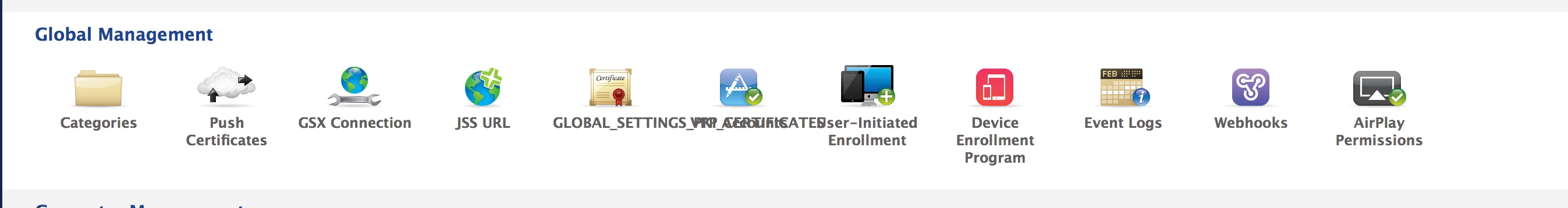

  • April 21, 2017
one more thing..
See middle letters
Is anyone able to get rid of these 3 2 errors so far?
I was able to fix the certificate one
  • April 21, 2017
I've seen that over lapping of text as well in 9.98. I think it's just some type of HTML formatting error that has been introduced in 9.98. It hasn't really caused any big issues for us that I know of. My guess is that it will be fixed in 9.99 or what ever the next release is.

@jtaveras and @rcorbin - I was seeing the same overlapping formatting issue as well as the "SERVER_INFRASTRUCTURE" sidebar issue after upgrading to 9.98, and clearing the cache fixed both for me.
