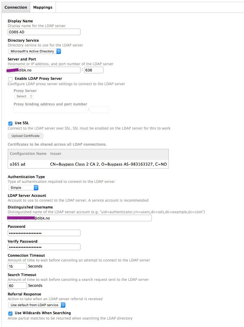

Setup
In our example, we are using the AD domain "dibk.no", so we have defined an LDAP server in the AADDS setup. The port will always be 636, and you need to upload the SSL certificate, both to Azure and to the Jamf server, like we have done here.
Use the simple authentication type, and make a service account in Azure AD to authenticate with. Beware that this account must have its password set AFTER you set up Domain Services in order to work. The account must be specified as 'user@domain', not the DN type suggested.

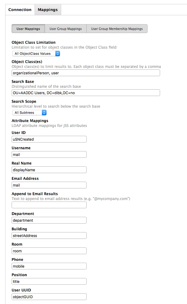

Mapping
The mappings were a bit time consuming to figure out.
The User Mapping is mostly standard, but beware to use the Search Base "OU=AADDC Users, dc=yourADdomain, dc=com". Also, use mail as Username.

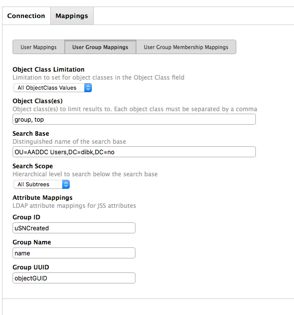

Same thing for User Group Mappings.

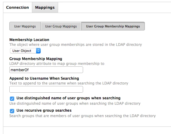

User Group Memberships uses the User object to store its memberships, in the attribute MemberOf.
And that is that for setting up LDAP with Azure AD. With this setup, it should be possible to login to Jamf Pro with a O365 account, provided that the password is reset after adding Domain Services to Azure AD.

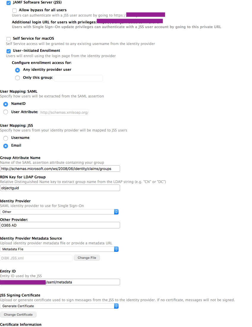

Back in Jamf Pro Single Sign-On Settings
Not much setup necessary. Set Identity Provider to "other", give it a name and upload the metadata XML from Azure AD under Identity Provider Metadata Source, make JSS generate a signing certificate, and specify the same Entity ID as in Azure ID (eg. "https://your-jss-server.company.com/saml/metadata").
Also, you need to specify the User Mapping in SAML and JSS as, respectively, NameID and Email. The Group Attribute Name (which doesn't work, BTW) should be "http://schemas.microsoft.com/ws/2008/06/identity/claims/groups". The RDN Key for LDAP Group should normally be "CN", but for Azure AD it should actually be objectGUID instead. Either way, it does not work at this time.
That should be it. You should now be sent to Microsoft to log in, and if successful, Jamf Pro will let you in afterwards.

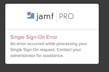

A little side-note
Even with a fully working SSO + LDAP setup, you (especially admins) will meet an error message from time to time, claiming that there was an SAML error stopping your login. This is due to some token renewal magic not happening correctly (probably) on the JSS side.
Luckily, there is an easy fix: Go to your Azure or Office portal and log out the session. Afterwards, going to the JSS will prompt a new SSO login, and all is well again. The error message might also be avoided by actually logging out of JSS when finishing up an admin session (but who really does that?).

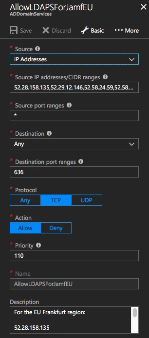

For the virtual network being used by the Azure Active Directory Domain Service, did you configure NSG to minimize the IPs that can communicate to it? If so did you use these?
https://www.jamf.com/jamf-nation/articles/409/permitting-inbound-outbound-traffic-with-jamf-cloud
eDooku
  • May 2, 2018 10:27 AM UTC
I did, in fact, configure NSG to minimise the IPs. And I used the list you link to. Since our organisation is being served from the EU, I opened for the IPs from the EU Frankfurt list, as seen in the image.

@eirikw Pointed out something pretty important. Ran into this error after completing the setup:
The resolution was to follow his advice:
"Go to your Azure or Office portal and log out the session. Afterwards, going to the JSS will prompt a new SSO login, and all is well again."

  • Aug 30, 2018 8:49 AM UTC
Thanks for the response, we had to change our user mappings slightly
We added top and user to the object classes and the username field mapping to userPrincipleName
