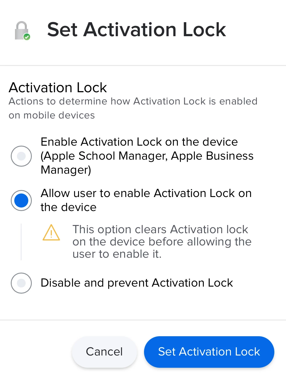

I’m guessing the only option would be the user to remove the device in their iCloud account
OR
I haven’t test these options in a while but could this have the desired effect if applied?
