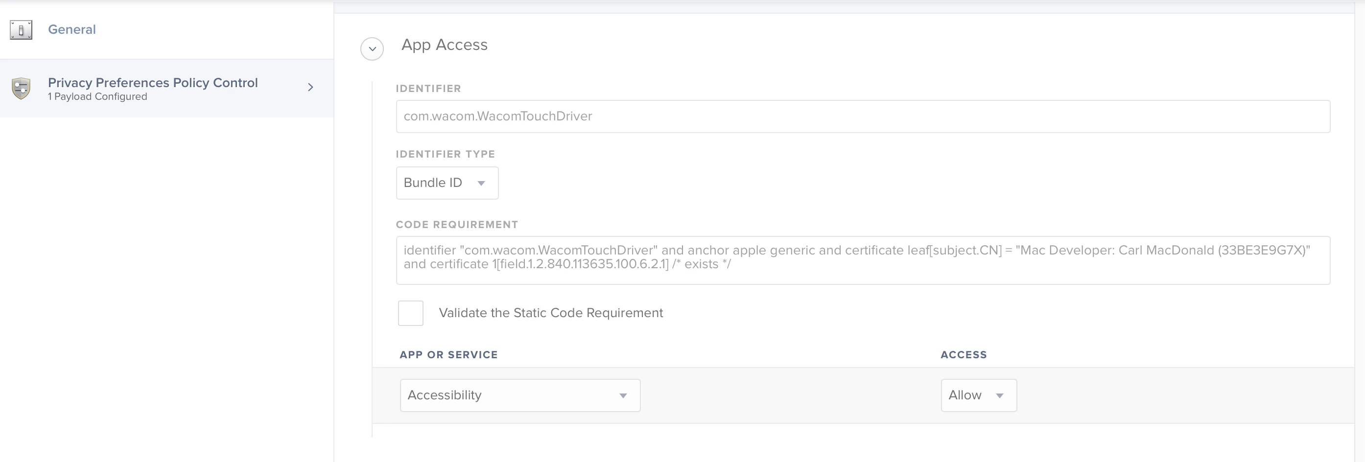

  • November 25, 2019
@carlo.anselmi I could use a beer today!
Here is what I've been using in Mojave for the Wacom touch driver.
Here is the identifier, if you want to copy and paste into your Payload.
identifier "com.wacom.WacomTouchDriver" and anchor apple generic and certificate leaf[subject.CN] = "Mac Developer: Carl MacDonald (33BE3E9G7X)" and certificate 1[field.1.2.840.113635.100.6.2.1] / exists / QuotedText
{/quote}

@carlo.anselmi I plugged it into the PPPC Utility and got a slightly different identifier.
Try
anchor apple generic and identifier "com.wacom.WacomTouchDriver" and (certificate leaf[field.1.2.840.113635.100.6.1.9] / exists / or certificate 1[field.1.2.840.113635.100.6.2.6] / exists / and certificate leaf[field.1.2.840.113635.100.6.1.13] / exists / and certificate leaf[subject.OU] = EG27766DY7)
  • December 13, 2019
@sdunbar Yes, that's it!
Thank you!
