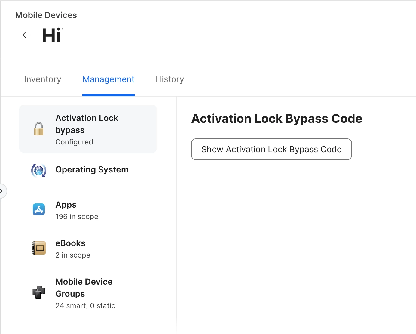

Hi @Icka ,
Find the activation code in:
Mobile Device > Management > Activation Lock Bypass Code

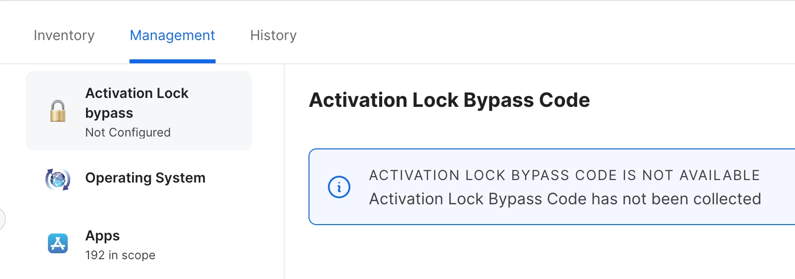

Note: Supervised: Yes – If the device is not supervised, the Activation Lock Bypass Code will not be available.

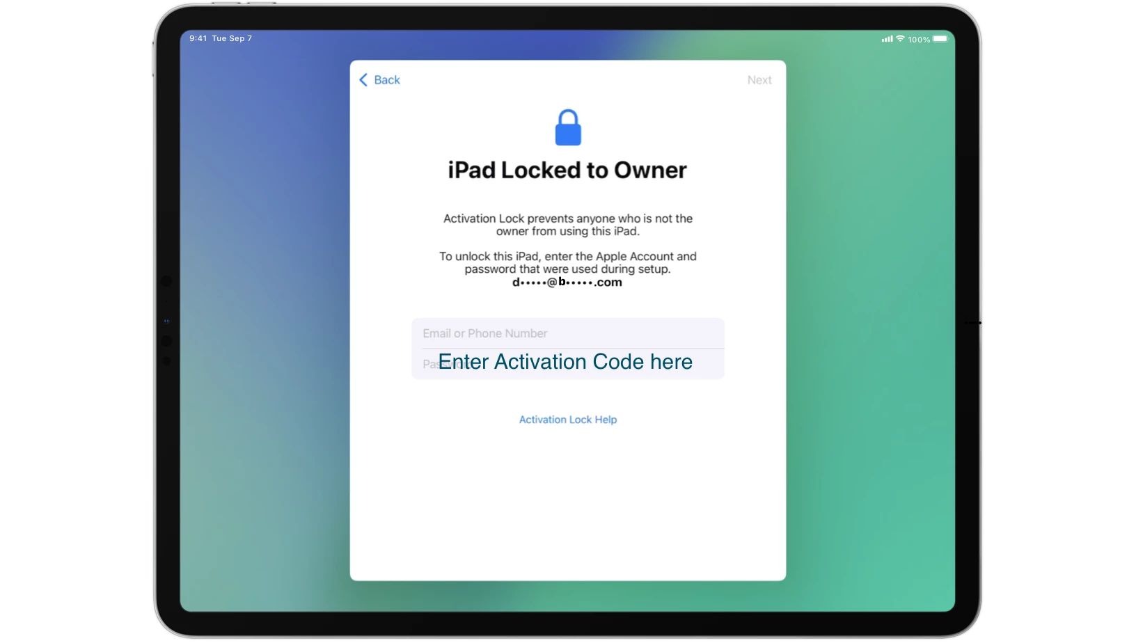

For devices locked with Find My, first, restore the device. In the password section, copy and paste the activation code (ensure the device is connected to the internet).
