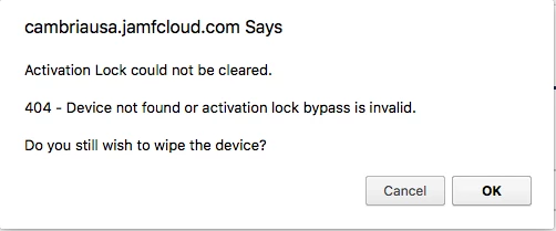

Another thing that has recently stopped working when I try to 'clear activation lock' is the error : 'Activation Lock could not be cleared> 404- Device not found or activation lock bypass is invalid.'
JAMF support informed me there is nothing they can do about it, that is an Apple iOS 11 issue.

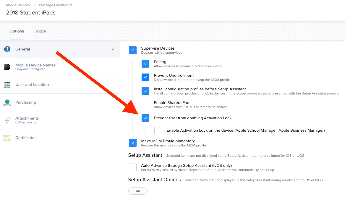

I asked as well, why does this happen? And she told me that this is 100% caused by the "find my ipad" feature. If we didn't use that feature, then this wouldn't be a problem. WOW i said, and sure enough, our student configuration profile is set to enforce find my ipad to 'allowed'. I changed it now to "restricted" in jamf configuration profile and we will see if that helps going forward. I am not sure if this prevents the geolocation of ipads. I had always turned it on when i used meraki for management, because then you could see the ipad on a map. JAMF does not seem to have a map interface that i can see, so the utility of this would be limited in the jamf implementation anyway. Cant think of any other reason why this would be turned on for all students. But the previous admin is no longer here to ask about why he did that initially. I don't think location services are disabled completely by this change, and hopefully its just that one feature that i have disabled.
I am still pretty new to this, so we will see if i have to roll this back if it causes some other issues. I will post back if that is the case. Hope it helps someone.
EDIT: i should also add that all my prestage enrollment has to disable "activation lock" yet still they were getting it on there i would assume, after the fact.
