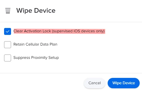

Jay_007
When wiping iPads and selecting the option to clear the Activation Lock on ADE iPads, the device wipes as normal, but then users are prompted to enter the organization's Apple ID to unlock the device. The recorded bypass code in Jamf Pro still works, but I cannot figure out why it keeps failing to clear it.
Server logs show this error message (serial has been removed):
2022-08-29 02:59:03,208 [ERROR] [ina-exec-45] [ActivationLockService ] - Failed to clear activation lock for (SERIAL). ActivationLockResponse [status=404, message=Device not found or activation lock bypass is invalid.]
Is anyone else experiencing this problem or know what could be causing it? It's happening on multiple iPads.

@Jay_007 Just updating this post that my case with Jamf is being escalated. Currently our environment has disabled Activation Lock as well. The Apple ID that you had to provide to unlock the devices. Was this the ID that you used to configure ADE token between ABM and Jamf? I would have to look back but I believe I found some reference that tied the Apple ID that setup the token connection as being the ID locked to the devices.
Jay_007
  • Sep 22, 2022 9:21 PM UTC
You have disabled Activation Lock and devices are still locking themselves to an Apple ID? If so, this is a different issue to what I'm experiencing. Or you have just disabled it because you're not sure what Apple ID they're locked to?
Yes, that is exactly what enabling this setting does. It locks devices to the organisation's Apple ID (the one that was used to link ADE with Apple Business Manager using the server token). This is expected behaviour.
My issue is, Activation Lock is failing to clear when selecting this setting during wipe:
I have supplied Jamf support with some logs and they're investigating. I'll share any updates I get.

Sorry for the confusion, we are on the same boat. We have disabled Activation Lock in order to not experience the device lock issue when attempting to wipe an ADE iPad that is set to clear activation. What you have highlighted is the same experience for us. Will provide updates as well.
Jay_007
  • Sep 23, 2022 1:21 AM UTC
Ah ok, thanks for the clarification. It's nice to know that I'm not the only one out there with this issue. I guess we'll have to wait and see what Jamf support can find out.
