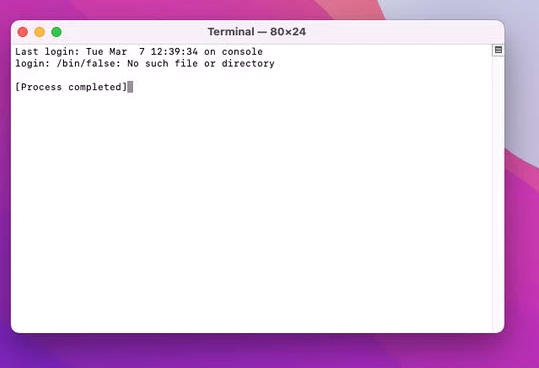

I am still pretty new here so bear with me on this one. Our organization uses binds our Macs to AD and people sign in to create mobile accounts. These accounts have admin privileges but some things are restricted. For example, terminal access on mobile accounts is deactivated. When you open a prompt, the terminal window says "process complete" and doesn't let you enter anything.

/bin/false is a way to disable Terminal login access, and this can be set for mobile accounts in your binding settings.
I'm not sure if you have a Jamf binding config that is doing the AD bind, or if it's being done in a config profile. But in either case, you should check to see if the Default user shell is set to something other than /bin/zsh (or /bin/bash for older OSes). My guess is that setting is set to /bin/false. Someone likely did that to prevent end users from opening a shell prompt.
For your existing devices, you can change the shell for each user account with a script. For example,
/usr/bin/dscl . change /Users/username UserShell /bin/false /bin/zsh

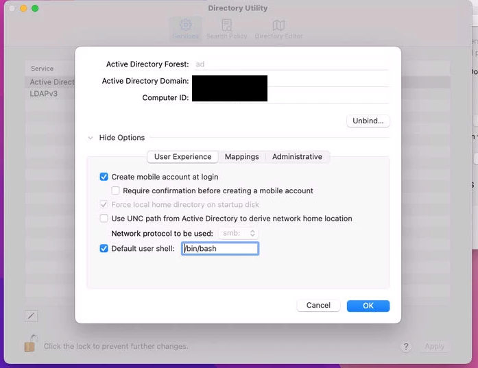

Also, I was looking at our binding set up in AD. It seems that we had it set properly so I think there must be a policy or something that is changing it to bin/false. I am not seeing it but I will keep digging in. Here is a screen shot of what we currently have.
Sure, it's entirely possible that there's a policy running a similar command to the one I posted above, but in the opposite direction, going from /bin/bash or /bin/zsh to /bin/false. It's an easy thing to script, so that may be it, especially if it's not being set within your AD binding.
Hopefully you find it and disable it if that's the end goal, because if the policy happens to be set to Ongoing, some of those accounts may end up getting set back to /bin/false for the user shell.
