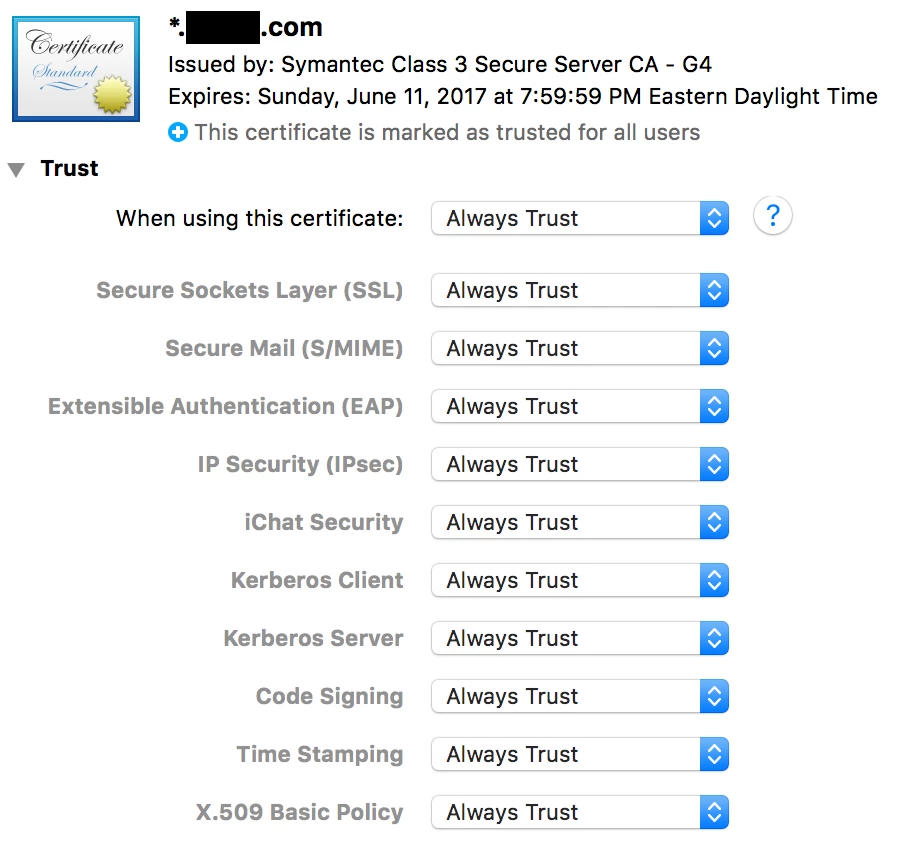

Greetings!
Having a bit of trouble with a host name mismatch on a ceritificate that's causing an issue with Outlook on startup.
So far, I've added and exported the certificate in Keychain Access, uploaded it to the JSS in a configuration profile, and then tried to deploy it to a test computer but the problem here is that the trust settings are set to Use System Defaults.
Then, I tried packaging the certificate up with composer and copying it to /tmp and installing it with this command:
/usr/bin/security add-trusted-cert -d -r trustAsRoot -k /Library/Keychains/System.keychain /tmp/certificate.cer
Which does add it and set to Always Trust...

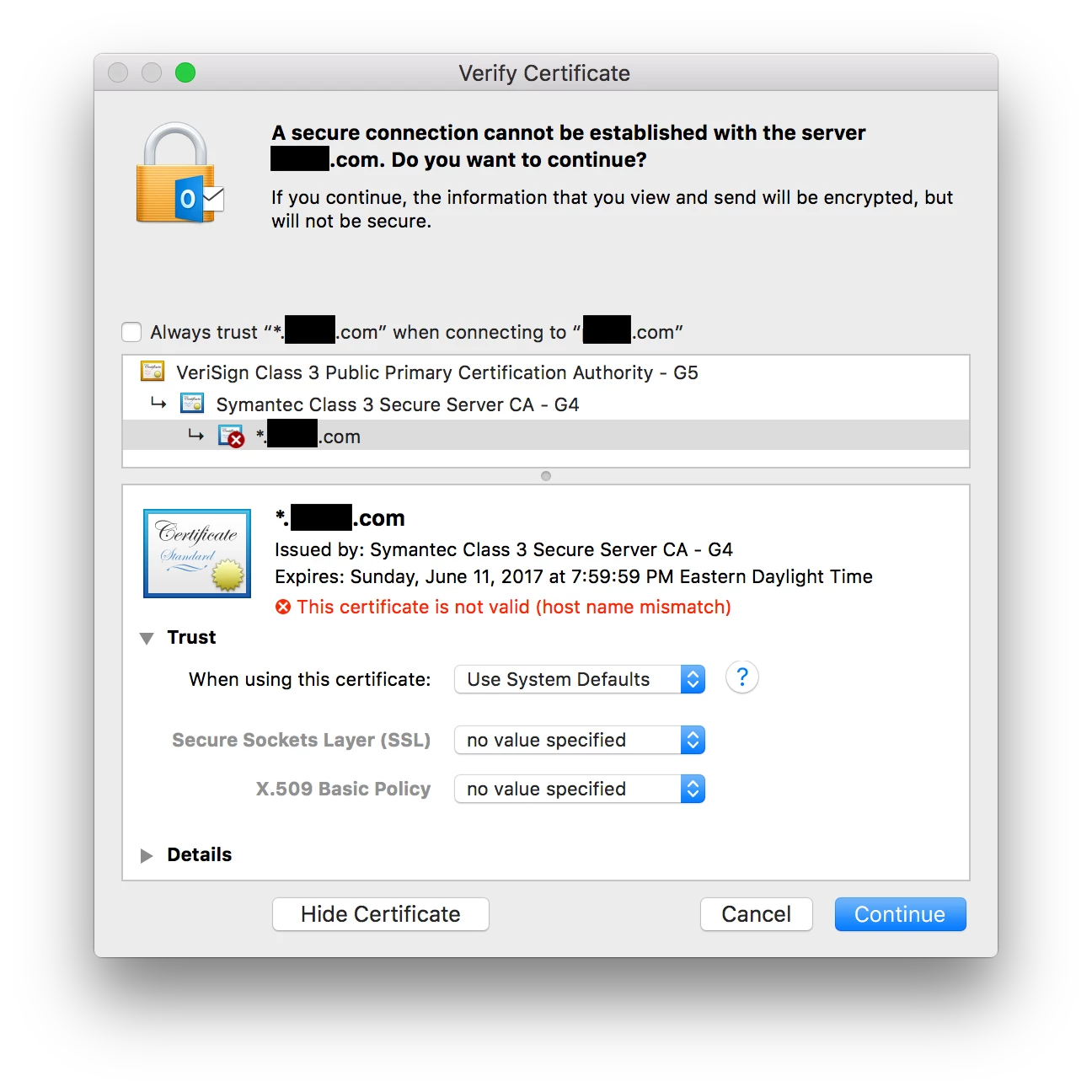

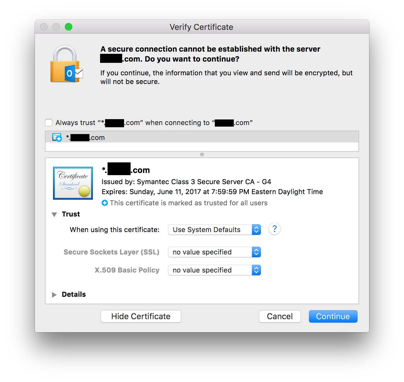

However, I still see the Verify Certificate message when Outlook is opened and Use System Defaults as the Trust settings even though the certificate is marked trusted for all users.
Any thoughts on what I might be doing wrong or another way to go about adding this certificate to the keychain and setting it to Always Trust?

@AVmcclint I have had inconsistent results deploying certificates with Configuration Profiles as Always Trusted. Our root CA seems to install correctly, but there have been times they do not install as Always Trusted (such as this problem with Outlook). I have also tried creating a Profile in the JSS with the certificate payload and downloading it, then striping out the signing and re-signing with our Developer ID Installer certificate. When I examined the certificate in Keychain Access, I found that it did install the certificate and set the trust settings to Always Trusted, but I was still seeing the "A secure connection cannot be established..." message when opening Outlook. It was only when I packaged up the certificate and used this command from the thread above that I was able to install it with the correct trust settings.
/usr/bin/security -v add-trusted-cert -r trustAsRoot -e hostnameMismatch -d -k /Library/Keychains/System.keychain /tmp/SOME_CERTIFICATE.cer

Hey this is great - I was having the exact same problem with Outlook 2016 prompting the user on a host name mismatch of the server's certificate due to it being hosted on a distributed platform.
The solution is to either trust the cert at each workstation or issue a new cert with the mismatched domain as the subject alternative domain, per https://support.microsoft.com/en-us/help/3066652/certificate-warning-in-outlook-2016-for-mac - which did you do? I'm guessing it may have been easier to package and deploy the certs with a postinstall script than it is to persuade those responsible getting that newly trusted cert? That's the method I'm going with.
