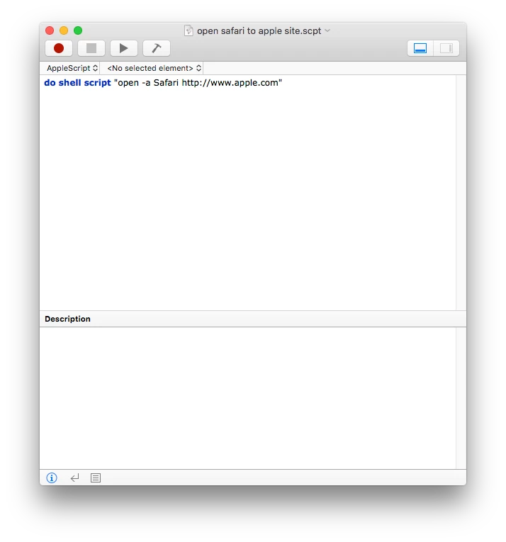

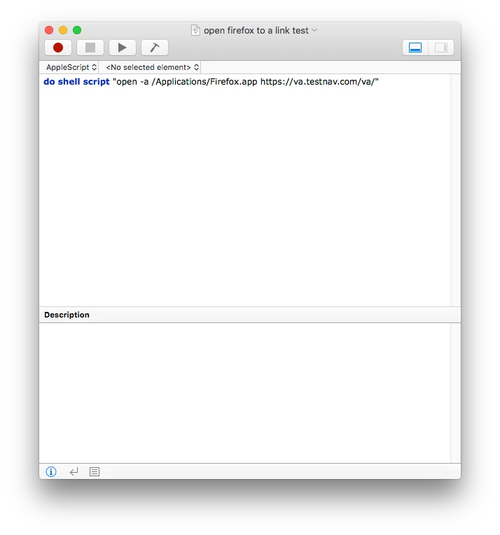

mvu
Forum|alt.badge.img+22
  • August 25, 2016
@JaredFlitt What I used for AppleScript. Just change to desired website.
Choose File, Export, File Format is Application, Save.
  • August 26, 2016
