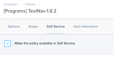

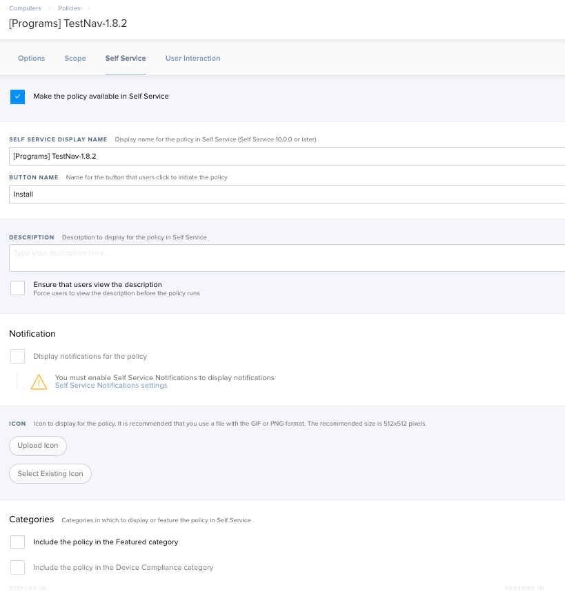

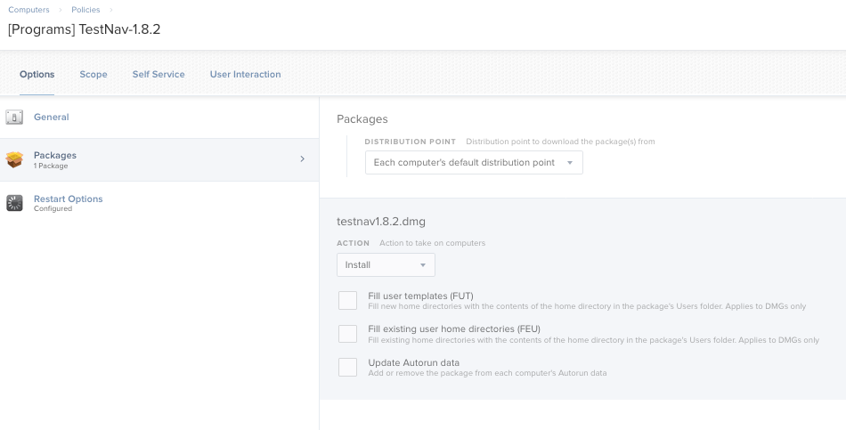

macOS or iOS? The process is different for each, and I can't really guide you that well on the latter.
If this is for Macs, you have to have some kind of install package created and uploaded into Casper Admin/on your CasperShare that will install the software, like Skype for Business. Then create a policy, just like you would for a silent install policy, add the aforementioned package and any scripts or other items to it like usual. Then click the Self Service tab in the policy creation setup and check the "Make available in Self Service" checkbox. You can then set up a description, button name, add an icon, etc. Finally, set the appropriate scope, like against a Smart Group of machines that do not have it installed, or are out of date, and it will show up for them in the Self Service.app once you save the changes.
