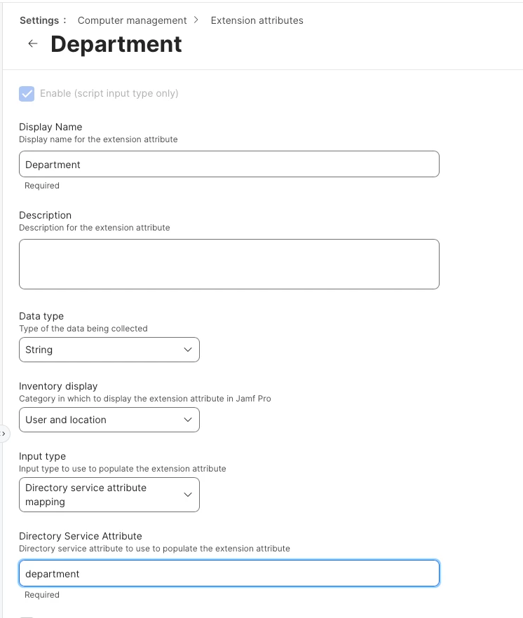

you can use Extension attributes to Map your Active Directory Department to JAMF, The Default Department option we have in JAMF is used when you manually create a Department in JAMF,  Check the Attribute value in AD for Department and create an EA.
@Shyamsundar, this is awesome! I never knew about this just added it to my Jamf. Department is pulled from Entra and will be very useful.

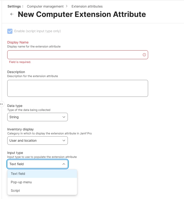

gmihailo
  • Apr 23, 2025 3:04 PM UTC
I don't see this? And I use Entra as my Identity Provider?

Did you have Entra ID Linked with JAMF in the Cloud identity providers

yes, I use Azure Entra AD, I have linked the same with JAMF from the cloud identity providers in the Settings
@Shyamsundar  Yes it is linked. I also don't want an extension under the user & location fields where Department is already.  I think this exercise here just proves you have to add the departments manually one... at... a .. time... I am going to open a ticket with Jamf.  Thanks all for all of your suggestions.
