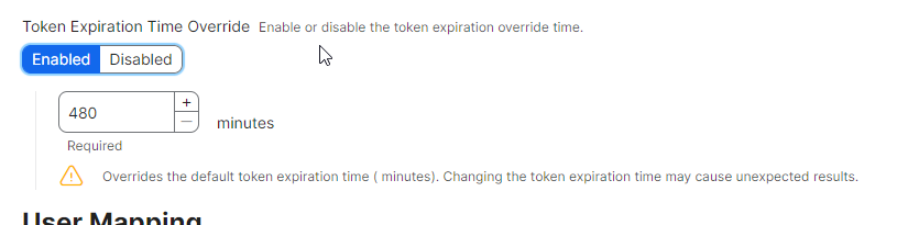

  • Apr 16, 2024 2:11 PM UTC
Check your SSO settings. There's an option for token expiration and it sounds like it's set to expire too quickly. I think the default for Jamf is 120-minutes, but this is totally configurable to whatever you want in minutes.
Settings > System > SSO is where you'd find the token expiration setting.

  • Apr 16, 2024 4:39 PM UTC
ok! going to try that one. Was set to disabled, so i set to 480 minutes now.
EDIT: spoke to soon. no one else can log in at all (single sign on error) if this is changed, so DONT change it...
