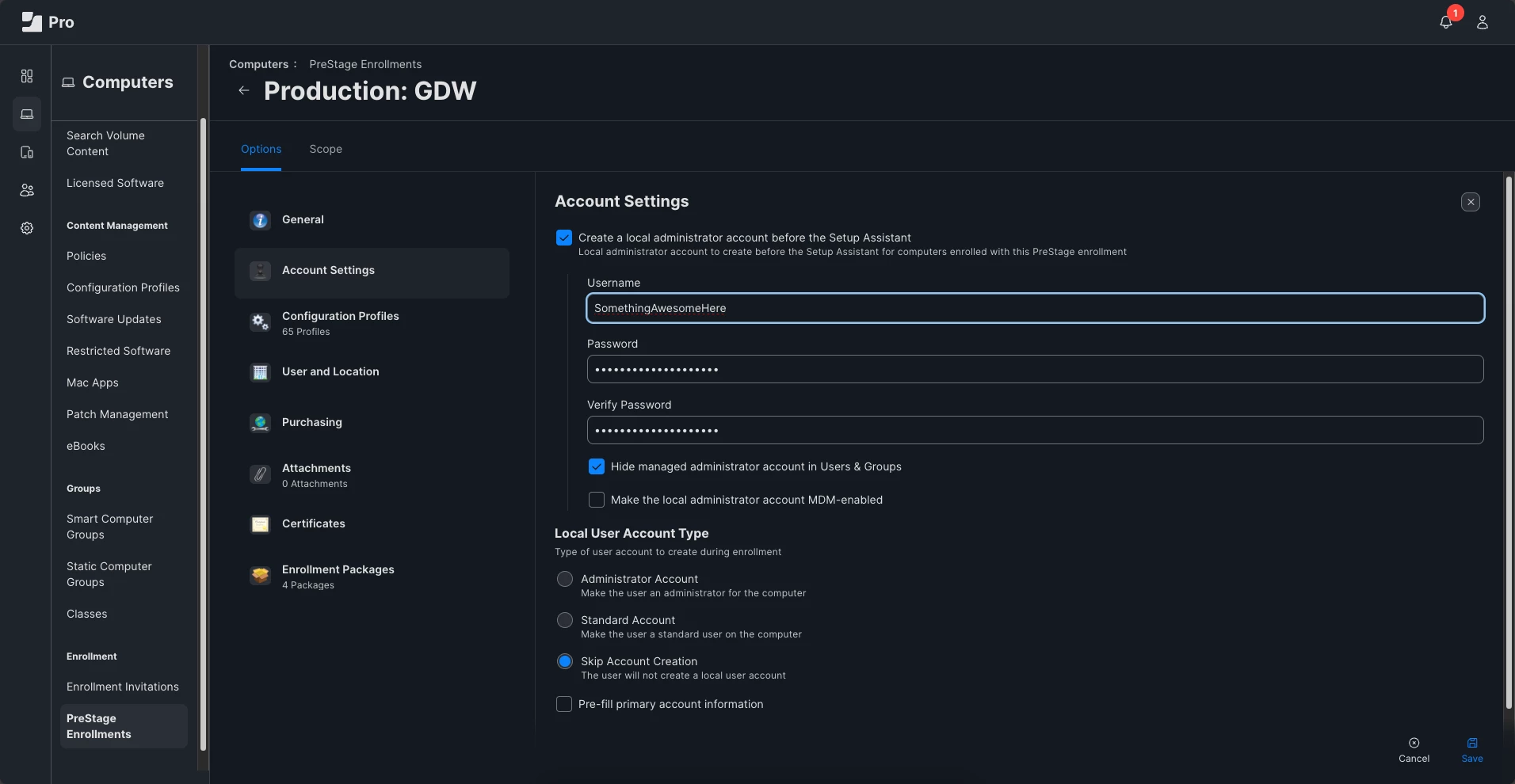

For some years now we've been encountering the odd mac where even though newly-enrolled, the local admin password does not work. With no way to login, we were reduced to Recovery Console, wipe and re-enroll.  To mitigate this we created a backup admin account to allow us a way in, but with the advent of Secure Token things have got weirder. Has anyone experienced this?  Here is our setup:
1. Our student macs are enrolled with a prestage where a single local admin account "Admin1" is created before setup assistant.
2. A Jamf policy then creates a second admin account, "Adminbak".
3. Setup assistant does NOT create a local account, instead we later bind the macs to ADS and network users then logon.  Adminbak was created to be the first account created after setupassistant, so it would get Secure Token. Our onsite techs can then logon to each machine with Adminbak to enable bootstrap.

Secure Token generation typically can only happen when an account interactively logs in to macOS. Depending on how an account is created DHCL can be told to force generate the first Secure Token which is generally not a good thing to happen, especially if you don't know the password. Jamf does not use this flag when creating an admin account using Pre-Stage, so your first admin account (created with Pre-Stage) should not have a Secure Token until you log in to macOS with it. Since your Pre-Stage Admin account has a Secure Token and no one is logging in with it, something does absolutely seem strange.
Jamf should be able to tell you if an account is a local account or a mobile account. Generally speaking, without a ton of scripting there is not a way to make a local account into a mobile account. MacOS is not really designed to use domain binding anymore and has not been for a very long time. When you log in to a mac, macOS first checks the local keychain. If it sees credentials that match what you are using it lets you log in. If it does not see credentials for what you are using, it will shake (bad credentials). If you are domain bound or have PSSO enabled macOS will check the IDP to see if the user's credentials exist (never mind Okta nor Azure support on demand account creation yet). I don't see how the local account could become a mobile account, but you could skip AD binding the device to check that.
Have you tried removing and re-adding your local admin account in the Pre-Stage?
Depending on your Jamf Settings, the Jamf Binary may also make a local admin account. Both this Jamf Binary account, and the Pre-Stage account should be able to have their passwords checked out in the Jamf Console or using LAPS. Any luck with checking out Managed Admin Account passwords?
