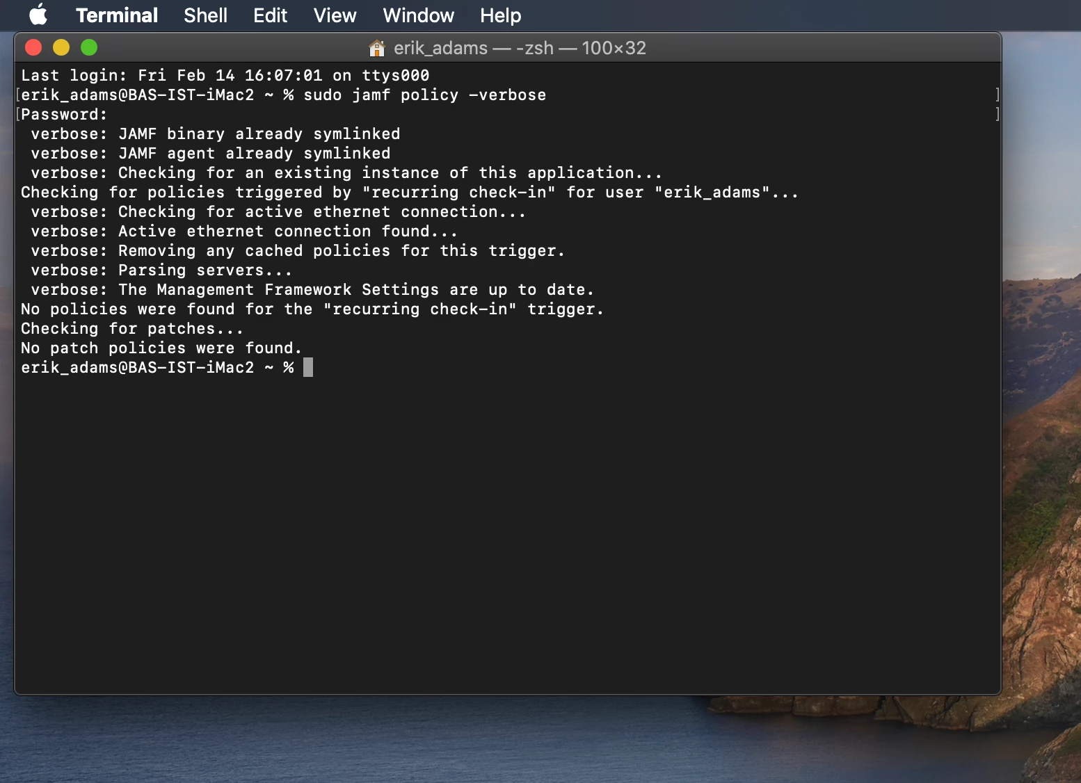

I looked through the existing discussions about this topic but there weren't any that fit the issue I am having. Our process for deploying Adobe CC is creating a package using Adobe Admin Console, downloading that package and running the downloader file, copying that package over to Jamf Admin. From there we create an install policy and scope that policy to the machines that we want to install the software on. Everything has been running smooth with no issues. That is until I tried to run that policy on an iMac with Catalina 10.15.
I noticed that the software had not installed so I checked the logs on that policy and on the machine name that has 10.15 is just says pending. It has been that way for four days. I then tried running the "sudo jamf policy -verbose" command in Terminal and I received the following result (See attached image).
I have run this same exact process on iMacs with 10.13 and 10.14 with no issues. I am in need of some help. I have got to get this one figured out ASAP. Thank you in advance.

Are you caching then installing cached? If so is the computer scoped to both cache and install cached? Are you able to install other policies okay on this iMac?
Have you tried setting the policy to a different trigger like on startup?
Also confirm your sudo Jamf checkJSSConnection to ensure all’s working.
I’ve installed the latest CC 2020 on a new Catalina iMac and all’s fine.

@robertojok THANK YOU! Just to be clear, it was definitely a mistake on my end. Sometimes it just takes an outsider to jog your memory. After I looked at your replay I checked the trigger and it still didn't work. Then I glanced at your replay again and it hit me, the scope! I checked my scope and I had some naming convention issues with the computer names. I made those changes and I have been able to successfully push the Adobe CC package to two different machines running 10.15.3. Thank you again.
