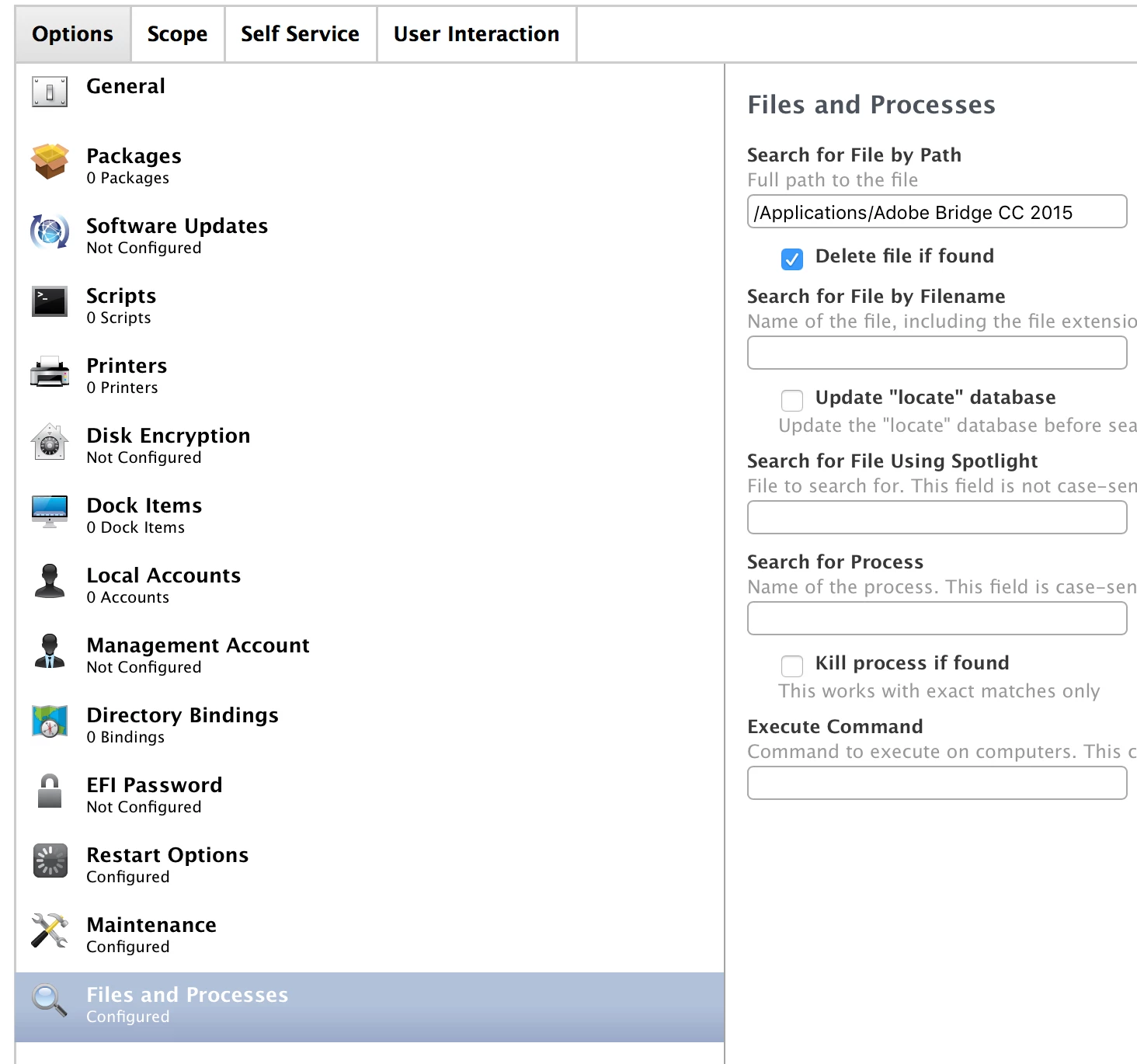

@djdavetrouble I am in the same boat. I'm trying to find a tool or/and script or something better to set up for JSS to go out and hunt for the older version of the software. I have tried below screen shot. Thinking it might work
