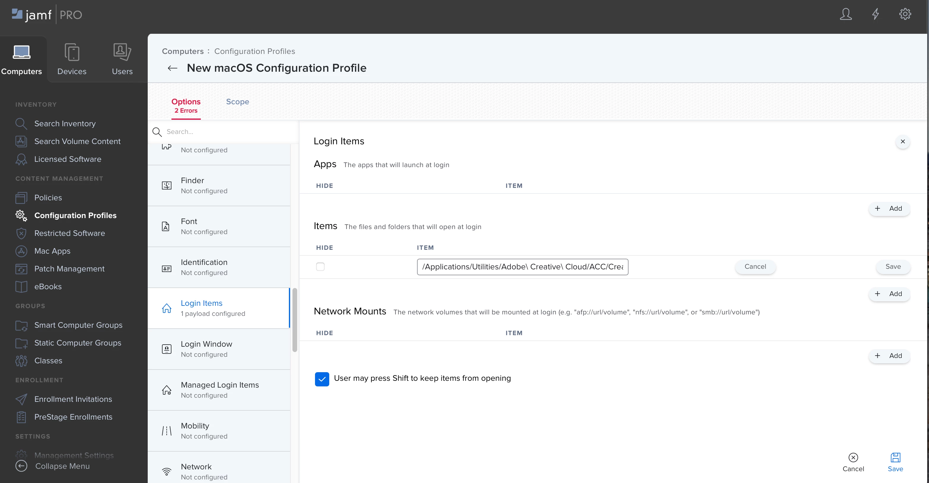

Maybe something like this?

Thank you for the reply  obi-k !   that is a good idea (and i will try it ) but I don't think that will change the settings in the app itself ... and I think those settings affect how the updates get handled ... maybe that would allow the Creative Cloud Desktop to run and update itself ... but I think that it may still not update ?
I see multiple places where a setting seems to be stored for the load on logon ....
/Library/LaunchAgents/com.adobe.AdobeCreativeCloud.plist
/Library/LaunchAgents/com.adobe.ccxprocess.plist
/Users/username/Library/Application Support/Adobe/OOBE/com.adobe.acc.default.prefs
I am going to try to look at what all changes when those settings are changed by the user using FSMonitor

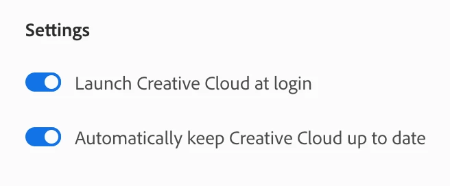

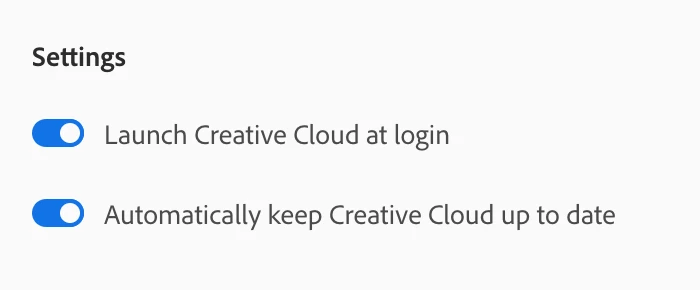

back to my original post on this topic:
Does anyone know how to force these settings for all users for the Creative Cloud Desktop app?
Thanks in advance
