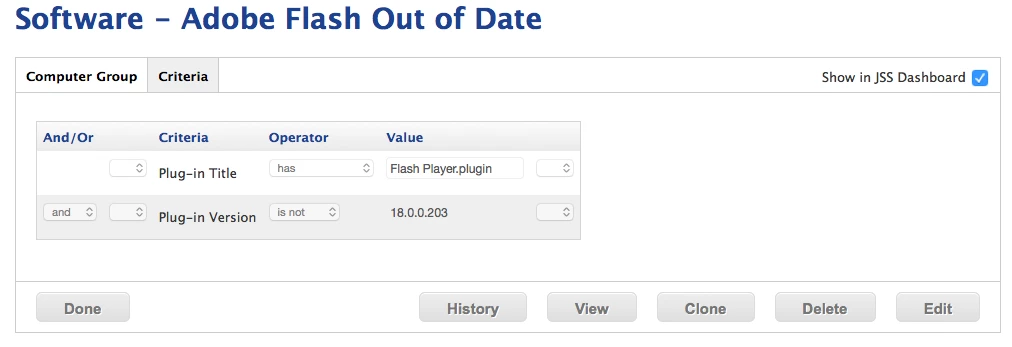

  • July 9, 2015
I've always done mine like the attached file (old screen shot, but same effect), with trigger: recurring check-in & logout, Frequency: ongoing. No problems. Does require Updating Inventory to be checked. I'd check out client logs to make sure they're actually checking in with the JSS to execute policies.

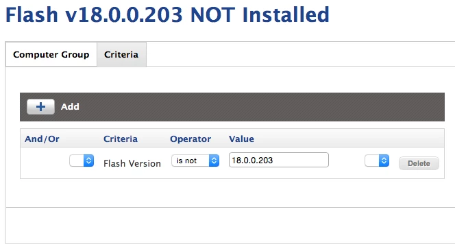

  • July 10, 2015
I use a payload free installer that @rtrouton created from HERE to install flash.
Then scope it to any machine that does not have flash v18.0.0.203 installed (see image attached)
Works really well, error free!
