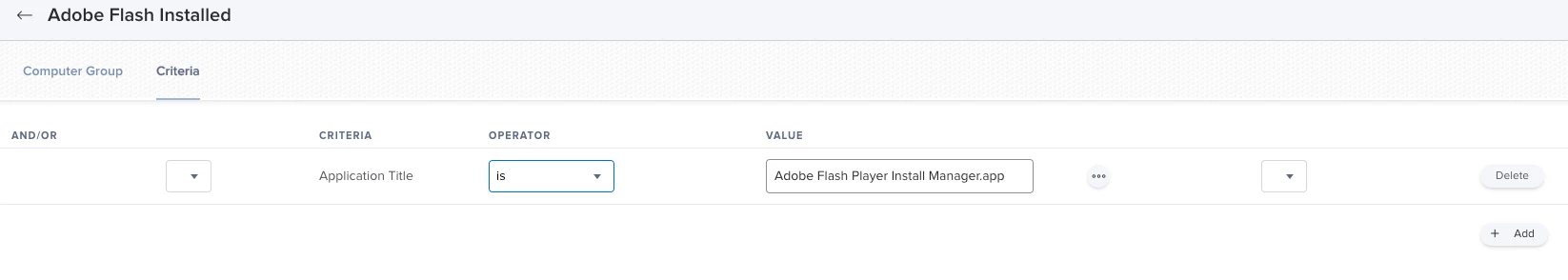

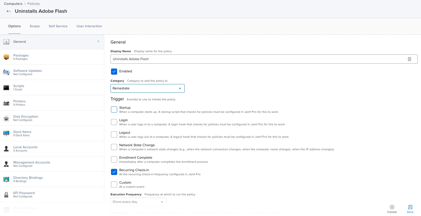

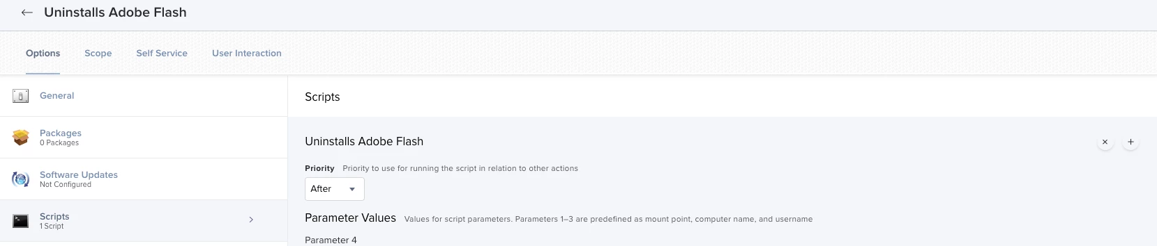

@sanbornc I've used the script which @cmcdonald89 has recommended above and linked this to a policy which runs everyday on a recurring check-in and this seemed to remove Adobe Flash fine.
I've created a smart computer group to show how many Macs have Flash installed, luckily for us we have just moved to Jamf so all our Macs have pretty much been Erased therefore we only have a small number of Macs with Flash installed (Mainly my test Macs). For my settings on the Flash smart group i've used Application Title is Adobe Flash Player Install Manager.app and this has pulled back all Macs with Flash installed.
After the script has ran the smart group has removed the Macs this successfully ran on. I've attached screenshots on my configuration, hopefully this helps a few admins.

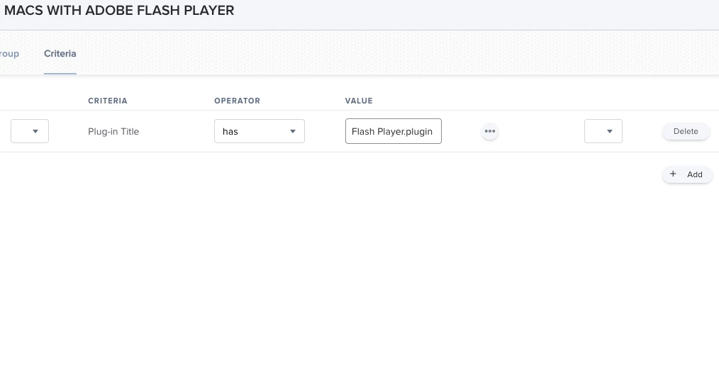

@Tomsmithdrpg here is my Adobe Flash smart group criteria
  • May 11, 2021 2:45 PM UTC
@tcandela It was 100% silent for me. The check portion at the bottom is probably what you're seeing when the install manager is running. I used an extension attribute to determine if it was installed and created my smart group based on that data.
Forum|alt.badge.img+20
  • May 11, 2021 3:02 PM UTC
looks like on the 2nd test computer the uninstall flash was silent, i did not see a popup. Maybe the first time it was just the usual annoying popup that adobe runs.
i don't use a EA for adobe flash since the RECON grabs 'plug-in title', so i just use this in my smart group.
