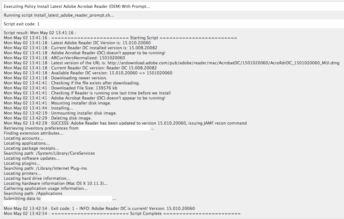

I've taken the work @joe.farage and @millersc have done and sort of ran with it. I updated the script to update both Reader and Reader DC to the latest Reader DC version. I also add an alternate download in case the client can't download the full installer. The attached photo shows what it looks like in the policy logs when it runs successfully (I have since changed the exit codes, so it should show 0 instead of 1 now). I have the JAMF RECON command if it's successful because I have it scoped to only run on machines that aren't current, and I want to make sure it falls out of scope ASAP when it's updated.
# ABOUT THIS PROGRAM
# NAME
#   AdobeReaderUpdate.sh -- Installs or updates Adobe Reader
# SYNOPSIS
#   sudo AdobeReaderUpdate.sh
# EXIT CODES
#   0 - Adobe Reader DC installed successfully
#   1 - Adobe Reader DC is current
#   2 - Adobe Reader DC NOT installed
#   3 - Adobe Reader DC update unsuccessful
#   4 - Adobe Reader (DC) is running or was attempted to be installed manually and user deferred install
#   5 - Not an Intel-based Mac
# HISTORY
#   Based on the threads:
#   https://jamfnation.jamfsoftware.com/viewProductFile.html?id=42&fid=761
#   https://jamfnation.jamfsoftware.com/discussion.html?id=12042
#   Version: 1.4
#   - v.1.0 Joe Farage, 23.01.2015
#   - v.1.1 Joe Farage, 08.04.2015 : support for new Adobe Acrobat Reader DC
#   - v.1.2 Steve Miller, 15.12.2015
#   - v.1.3 Luis Lugo, 07.04.2016 : updates both Reader and Reader DC to the latest Reader DC
#   - v.1.4 Luis Lugo, 28.04.2016 : attempts an alternate download if the first one fails
# Script to download and install Adobe Reader DC.
# Only works on Intel systems.

echoFunc "======================== Starting Script ========================"
# Are we running on Intel?
if [ '`/usr/bin/uname -p`'="i386" -o '`/usr/bin/uname -p`'="x86_64" ]; then
    ## Get OS version and adjust for use with the URL string
    OSvers_URL=$( sw_vers -productVersion | sed 's/[.]/_/g' )
    ## Set the User Agent string for use with curl
    userAgent="Mozilla/5.0 (Macintosh; Intel Mac OS X ${OSvers_URL}) AppleWebKit/535.6.2 (KHTML, like Gecko) Version/5.2 Safari/535.6.2"
    # Get the latest version of Reader available from Adobe's About Reader page.
    latestver=``
    while [ -z "$latestver" ]
    do
        latestver=`curl -s -L -A "$userAgent" https://get.adobe.com/reader/ | grep "<strong>Version" | /usr/bin/sed -e 's/<[^>][^>]*>//g' | /usr/bin/awk '{print $2}' | cut -c 3-14`
    done
    echoFunc "Latest Adobe Reader DC Version is: $latestver"

    if [ "${currentinstalledver}" != "${latestvernorm}" ]; then
        echoFunc "Current Reader DC version: ${currentinstalledapp} ${currentinstalledver}"
        echoFunc "Available Reader DC version: ${latestver} => ${ARCurrVersNormalized}"
        echoFunc "Downloading newer version."
        curl -s -o /tmp/${dmgfile} ${url}
        case $? in
            0)
                echoFunc "Checking if the file exists after downloading."
                if [ -e "/tmp/${dmgfile}" ]; then
                    readerFileSize=$(du -k "/tmp/${dmgfile}" | cut -f 1)
                    echoFunc "Downloaded File Size: $readerFileSize kb"
                else
                    echoFunc "File NOT downloaded!"
                    exitFunc 3 "${currentinstalledapp} ${currentinstalledver}"
                echoFunc "Checking if Reader is running one last time before we install"
                readerRunningCheck
                echoFunc "Mounting installer disk image."
                hdiutil attach /tmp/${dmgfile} -nobrowse -quiet
                echoFunc "Installing..."
                installer -pkg /Volumes/AcroRdrDC_${ARCurrVersNormalized}_MUI/AcroRdrDC_${ARCurrVersNormalized}_MUI.pkg -target / > /dev/null
                sleep 10
                echoFunc "Unmounting installer disk image."
                umount "/Volumes/AcroRdrDC_${ARCurrVersNormalized}_MUI"
                sleep 10
                echoFunc "Deleting disk image."
                rm /tmp/${dmgfile}
                # double check to see if the new version got updated
                if [ -e "/Applications/Adobe Acrobat Reader DC.app" ]; then
                    newlyinstalledver=`/usr/bin/defaults read /Applications/Adobe Acrobat Reader DC.app/Contents/Info CFBundleShortVersionString`
                    if [ "${latestvernorm}" = "${newlyinstalledver}" ]; then
                        echoFunc "SUCCESS: Adobe Reader has been updated to version ${newlyinstalledver}, issuing JAMF recon command"
                        jamf recon
                        if [ $readerProcRunning -eq 1 ];
                        then
                            /Library/Application Support/JAMF/bin/jamfHelper.app/Contents/MacOS/jamfHelper -windowType hud -lockHUD -title "Adobe Reader DC Updated" -description "Adobe Reader DC has been updated to version ${newlyinstalledver}." -button1 "OK" -defaultButton 1
                        exitFunc 1 "${newlyinstalledver}"

2016-06-03 10:36:04.611 defaults[28860:4321864]
The domain/default pair of (/Applications/Adobe Reader.app/Contents/Info, CFBundleShortVersionString) does not exist
any idea on getting the normal Reader working?
  • June 21, 2016
Which part of that script removes the Adobe Reader.app and replaces it with the Adobe Reader DC app? @PhillyPhoto
  • June 22, 2016
@bbot - It's part of the Reader DC installer package.
  • June 22, 2016
@PhillyPhoto Awesome, thanks for posting!
Everything is working great. I did find in some cases with users running 10.9.5. Not a huge deal as we're moving away from 10.9.5 at the moment.
Script result: Wed Jun 22 10:50:20 :
Wed Jun 22 10:50:20 : ======================== Starting Script ========================
Wed Jun 22 10:50:21 : Latest Adobe Reader DC Version is: 15.016.20039
Wed Jun 22 10:50:21 : Current Reader installed version is: 11.0.15
Wed Jun 22 10:50:21 : Adobe Acrobat Reader (DC) appears to be running!
Wed Jun 22 10:50:21 : Selection: 0
Wed Jun 22 10:50:21 : Exit code: 3 - ERROR: Adobe Reader DC update unsuccessful, version remains at Unknown!
Wed Jun 22 10:50:21 : ======================== Script Complete ========================

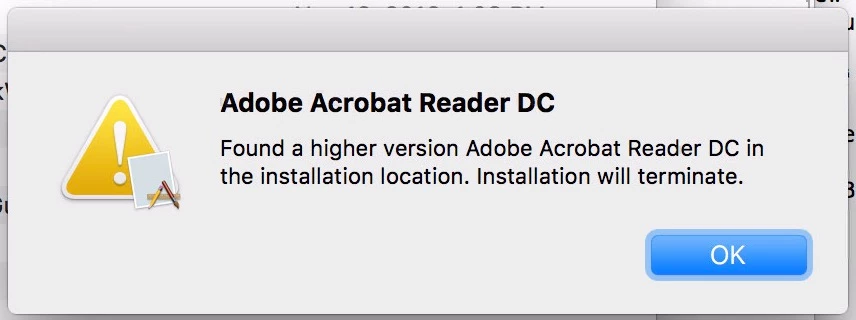

@joe.farage , @millersc and @PhillyPhoto
Running the latest tweaked version as well as the fixed version Joe posted, thank you all, and thank you for the logging! I see there's still nothing in the script to catch the possibility that Adobe screwed up or downgraded their release. I'm not sure there' s a single good way to handle that, but what Im seeing is that the assumption the the online version is different, is therefore considered newer during the compare, downloads, tries to install, but the app installer fails.
If you run it through the GUI, you get this message
I'm not a great scripter but Perhaps somebody could consider modifying the script so that if it's newer, it logs the message and leaves the newer installed. If it's older, it downloads the newer and updates and if it's the same, it just leaves it alone. Perhaps a popup could be built in to offer the end-user the choice to accept or defer/deny the change?
Since I run the script in the background in Casper, my users wouldn't see the message. But if it's run in Self Service, they see a Policy Failed message and no reason displayed to them, can be annoying.
I'd also like to see the echo's to the log and not just stdout.
these are not criticism, but some feedback based on my experience and could help us to better our product to those we support.
Thanks!
Fri Nov 18 15:18:47 : ======================== Starting Script ========================
Fri Nov 18 15:18:49 : Latest Adobe Reader DC Version is: 15.020.20039
Fri Nov 18 15:18:49 : Current Reader DC installed version is: 15.020.20042
Fri Nov 18 15:18:49 : Adobe Acrobat Reader (DC) doesn't appear to be running!
Fri Nov 18 15:18:49 : ARCurrVersNormalized: 1502020039
Fri Nov 18 15:18:49 : Latest version of the URL is: http://ardownload.adobe.com/pub/adobe/reader/mac/AcrobatDC/1502020039/AcroRdrDC_1502020039_MUI.dmg
Fri Nov 18 15:18:49 : Current Reader DC version: Reader DC 15.020.20042
Fri Nov 18 15:18:49 : Available Reader DC version: 15.020.20039 => 1502020039
Fri Nov 18 15:18:49 : Downloading newer version.
Fri Nov 18 15:19:15 : Checking if the file exists after downloading.
Fri Nov 18 15:19:15 : Downloaded File Size: 151020 kb
Fri Nov 18 15:19:15 : Checking if Reader is running one last time before we install
Fri Nov 18 15:19:15 : Adobe Acrobat Reader (DC) doesn't appear to be running!
Fri Nov 18 15:19:15 : Mounting installer disk image.
Fri Nov 18 15:19:19 : Installing...
Fri Nov 18 15:19:35 : Unmounting installer disk image.
Fri Nov 18 15:19:45 : Deleting disk image.
Fri Nov 18 15:19:45 : Exit code: 3 - ERROR: Adobe Reader DC update unsuccessful, version remains at Reader DC 15.020.20042!
Fri Nov 18 15:19:45 : ======================== Script Complete ========================
  • December 14, 2016
@chuck3000 Sorry no one has updated this thread.... darn turkey coma!
Update line 183 to the following:
if [ "${latestvernorm} -le ${currentinstalledver}" ]; then
You should be able to test and see the following result:
Wed Dec 14 13:08:41 :
Wed Dec 14 13:08:41 : ======================== Starting Script ========================
Wed Dec 14 13:08:42 : Latest Adobe Reader DC Version is: 15.020.20039
Wed Dec 14 13:08:42 : Current Reader DC installed version is: 15.020.20042
Wed Dec 14 13:08:42 : Exit code: 1 - INFO: Adobe Reader DC is current! Version: Reader DC 15.020.20042
Wed Dec 14 13:08:42 : ======================== Script Complete ========================
This should help with Adobe pulling updates, after the script has run. Also, what is the frequency you have your policy running for this?
Stand by.... seeing issues with Philly's script and the exit codes. Will update shortly.
        case $? in
            0)
                else
                readerRunningCheck
                sleep 10
                sleep 10
                rm /tmp/${dmgfile}
                        jamf recon
                        then
                        exitFunc 0 "${newlyinstalledver}"
                    else
                        exitFunc 4 "${currentinstalledapp} ${currentinstalledver}"
                else
                echoFunc "Curl function failed on primary download! Error: $?. Review error codes here: https://curl.haxx.se/libcurl/c/libcurl-errors.html"
                echoFunc "Attempting alternate download from https://admdownload.adobe.com/bin/live/AdobeReader_dc_en_a_install.dmg"
                curl -s -o /tmp/AdobeReader_dc_en_a_install.dmg https://admdownload.adobe.com/bin/live/AdobeReader_dc_en_a_install.dmg
                case $? in
                    0)
                        if [ -e "/tmp/AdobeReader_dc_en_a_install.dmg" ]; then
                            readerFileSize=$(du -k "/tmp/AdobeReader_dc_en_a_install.dmg" | cut -f 1)
                        else
                        readerRunningCheck
                        echoFunc "Checking with the user if we should proceed"
                        readerUpdateMan
                        hdiutil attach /tmp/AdobeReader_dc_en_a_install.dmg -nobrowse -quiet
                        /Volumes/Adobe Acrobat Reader DC Installer/Install Adobe Acrobat Reader DC.app/Contents/MacOS/Install Adobe Acrobat Reader DC
                        sleep 10
                        umount "/Volumes/Adobe Acrobat Reader DC Installer"
                        sleep 10
                        rm /tmp/AdobeReader_dc_en_a_install.dmg
                                jamf recon
                            else
                        else
                        echoFunc "Curl function failed on alternate download! Error: $?. Review error codes here: https://curl.haxx.se/libcurl/c/libcurl-errors.html"
                esac
        esac
    else
        # If Adobe Reader DC is up to date already, just log it and exit.
        exitFunc 0 "${currentinstalledapp} ${currentinstalledver}"
else
    # This script is for Intel Macs only.
    exitFunc 5
