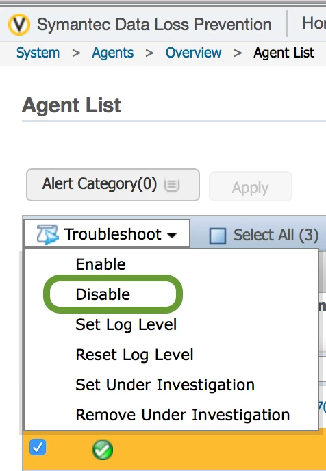

@donmontalvo this script worked for me. However only after disabling the agent in the DLP console first for the device I was trying to uninstall the agent from.
I'm running 10.12.6 and DLP 14.6 whenever I tried to use any of the advice from these sources:
https://www.symantec.com/connect/forums/how-do-you-uninstall-dlp-agent-mac#comment-11965751
http://eddiejackson.net/wp/?p=9022
https://help.symantec.com/cs/DLP15.0/DLP/v96304134_v120691346/Mac-?locale=EN_US
https://www.jamf.com/jamf-nation/discussions/26561/after-enrolling-shutdown-results-in-kernel-panic-before-the-shutdown-can-finish-10-13-2#responseChild161848
It would always like clockwork result in the Mac immediately kernel panicking, then rebooting. The agent was still running after this reboot.
What worked for me was:
1. Login to DLP console.
2. Disable agent associated with Mac.
3. Run donmontalvo's script against the now disabled agent Mac as an After policy in the JSS.
4. Stop swearing because theres no kernel panic in sight now.
