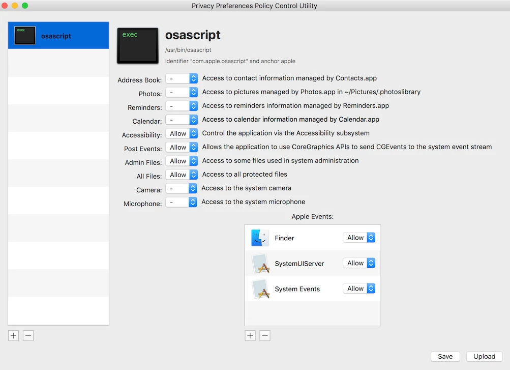

As I am doing this in Mojave I did have to also create a PPPC for osascript in /usr/bin using [PPPC Utility](https://github.com/jamf/PPPC-Utility as of 10.14.5 this is working.
