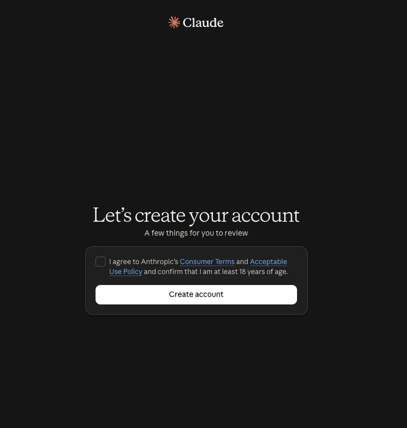

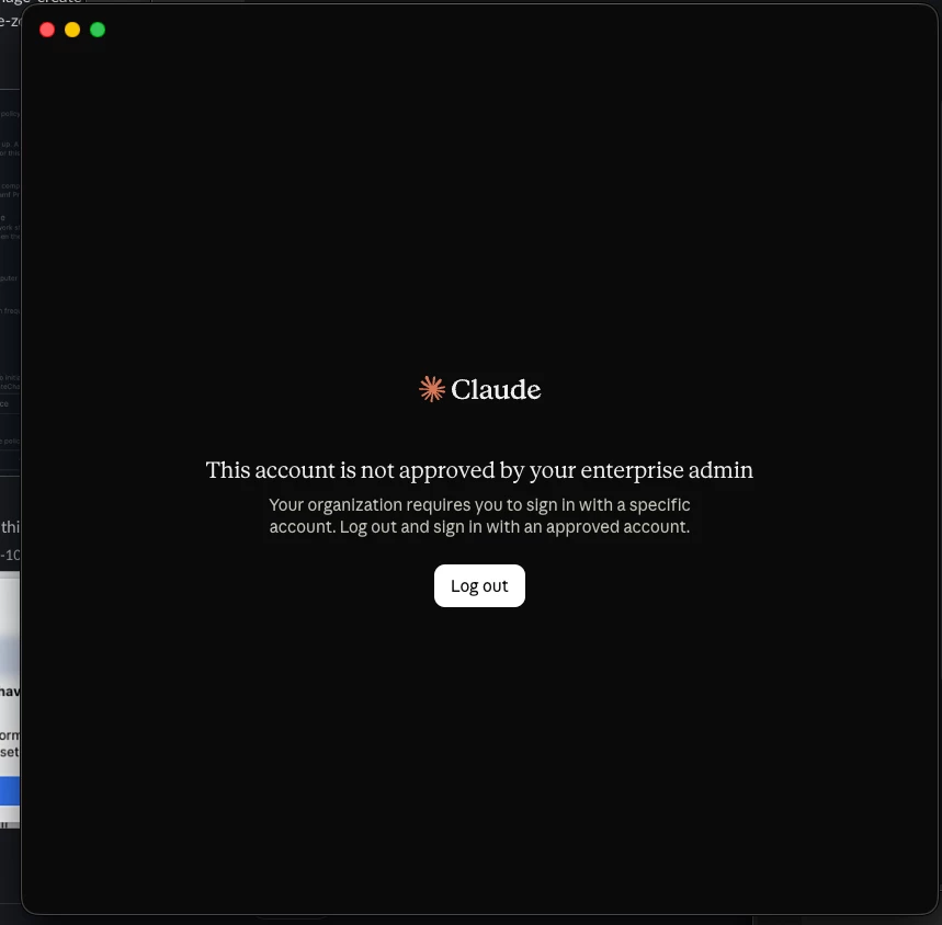

We are currently deploying some AI governance policies and have found that the policies I’ve written for Claude desktop do not translate to the claude.ai browser site. Working with my team to get Jamf Extender deployed. First image is a successful block in the Claude Desktop app, second is in the browser.
I expected some parity between the desktop app and the browser site, but I don’t see an option to configure the site specifically in the AI policies portal. Is there something I’m missing? Would Jamf Extender help with this?

Looks like you are using the forceLoginOrgUUID feature of the Claude desktop configuration, which is great!  Currently we only support the desktop app and claude code for this configuration and unfortunately, I do not believe that Jamf Extender can be used to implement this control in the browser.
If you use a proxy or a managed browser extension that supports http header injection the method outlined in this article enforces the same control.
I also want to mention that we do plan to extend AI Governance to the browser and this is a great use-case that will be at the top of our list.

We don’t currently use the managed browser extension but it is something I can bring to our AI governance sessions. I do help manage a SASE so I can see about implementing the http header injection to enforce this.
Thanks!
