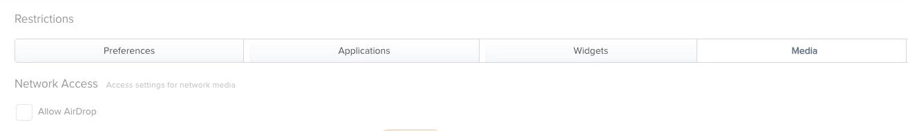

@tdenton Have you disabled AirDrop in both the Media and Sharing Services sections of the Restrictions payload of a Configuration Profile? That should work but if not you could try setting up a firewall rule to block traffic to the sharingd process. That would prevent AirDrop from working, but will also disable some other features like Handoff.

the restrictions payload seems to work fine in our org.

yes I am. in the configuration profile payload for restrictions there is a toggle box that seems to do the trick to disable it. Its in the Media section

thats what Im using i think this is on premise thing, see what jamf cloud brings I guess

@AtillaTheC Yep I have that doesn't seem to be disabling the preference pain though
Yeah I have that @sdagley

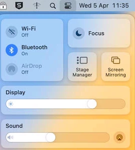

tdenton
  • Apr 5, 2023 10:36 AM UTC
for those interested turns out it is working looking in the wrong place woops
