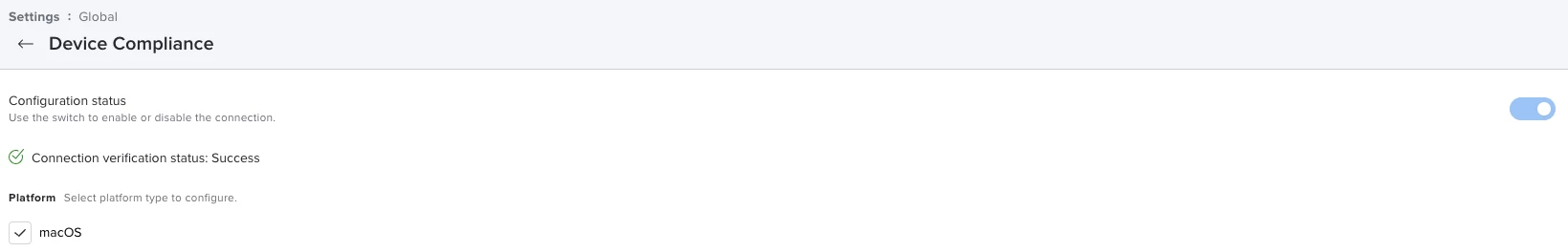

We have just setup "Device Compliance" (the new way) according to the documentation here: https://learn.jamf.com/bundle/jamf-pro-documentation-current/page/Device_Compliance.html in Jamf and are testing it. And for some reason, this (picture below) part doesn't come up sometimes and when it doesn't we have no clue on how to trigger it again. I noticed when i reinstalled one of my test machines, it didn't appear upon registering with Company Portal, another time it appeared and all was working perfectly fine. Now it doesn't matter if we delete the MS-Organization-Access certificate and the key Microsoft Workplace Join Key and then rerun registration with company portal. Any help is much appreciated!

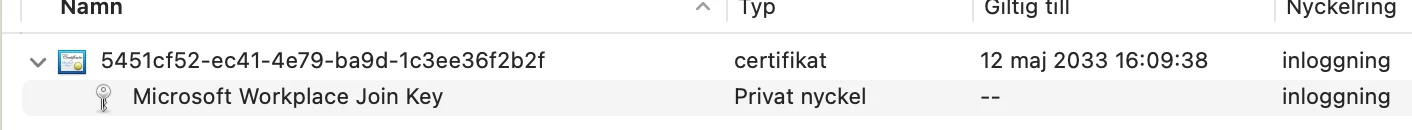

Hi @nadsad
You can create a EA to confirm that JamfAAD installed or not with the following
#current logged in user variable
currentuser=`stat -f "%Su" /dev/console`
#variable for current logged in user AAD ID cert. and WPJ key
AAD_ID=$(su "$currentuser" -c "security find-certificate -a -Z | grep -B 9 "MS-ORGANIZATION-ACCESS" | awk '/\\"alis\\"<blob>=\\"/ {print $NF}' | sed 's/ \\"alis\\"<blob>=\\"//;s/.$//'")
echo "<result>$AAD_ID</result>"
If that is showing and ID then you should check another thing which you have to be full Azure Admin AD and authenticate Jamf Pro instance from Azure AD by login from here
Settings -> Global -> Conditional Access -> macOS Intune Integration -> Jamf Native MacOS Connector Consent and click on Open administrator consent URL
That will take you to Azure AD and login there and approve Jamf pro. That should resolve your JamfAAD pop up issue.

Well that's the thing the consent is done and it's successful (see below picture) and we are using the Settings -> Global -> Device Compliance and not Conditional Access. So it worked first time then i reinstalled my computer and this time the JamfAAD thing didn't show up when i ran the registration with company portal, and you can see i have the key. But what i don't see which usually is created when JamfAAD pops up is /Users/$loggedInUser/Library/Preferences/com.jamf.management.jamfAAD.plist but i don't see this. I also see the device under User -> Devices in Azure. But without the JamfAAD authentication it wont work and iv'e been trying to figure out how to trigger it again but can't figure it out :(

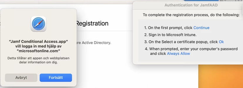

Ok just randomly I just reran registering with company portal and now the JamfAAD popped up and now this was also created. But i tried registering many times, no clue of why it worked now... pretty random and really bad if it happens in production.

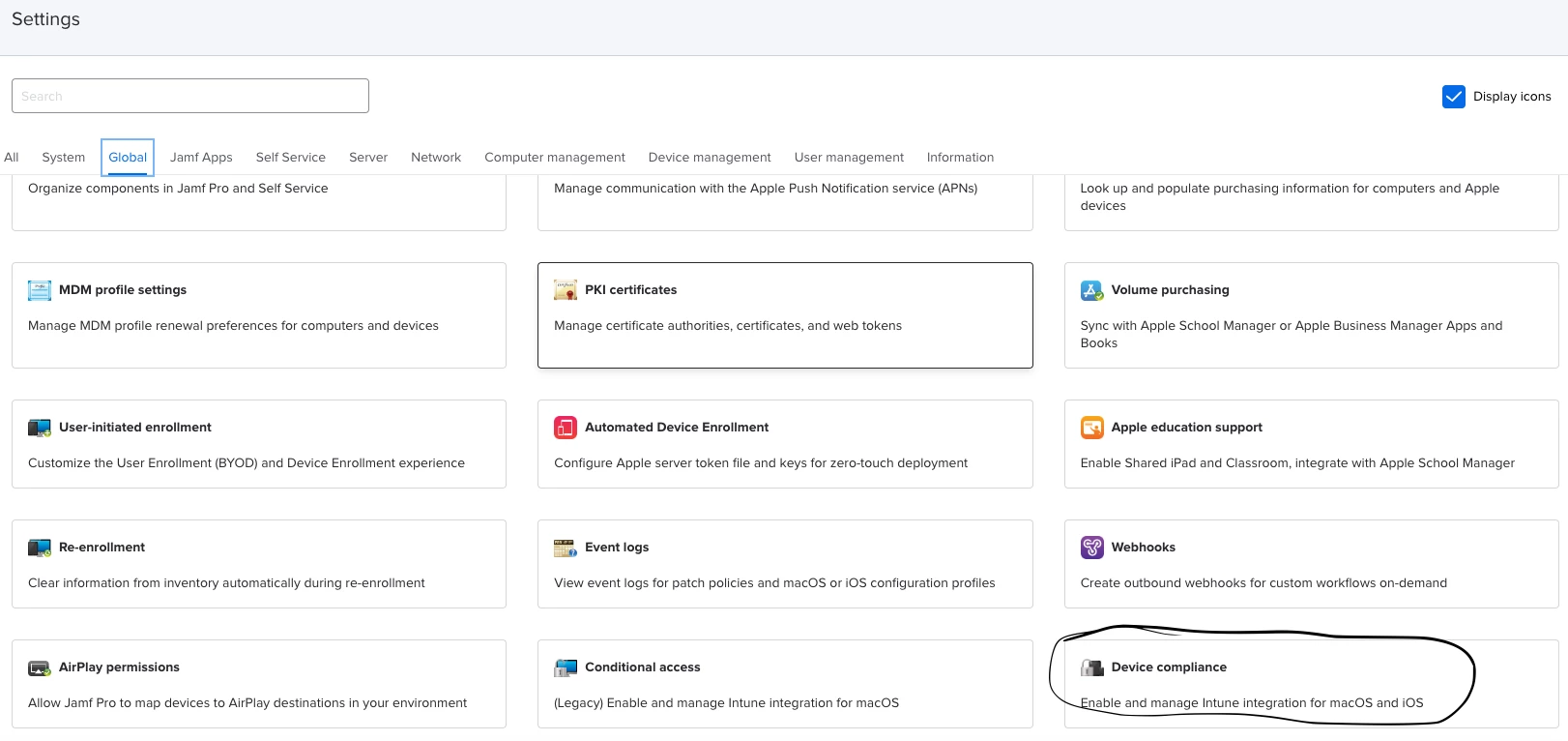

Hi @nadsad
I have no idea where you got device compliance? In my case Jamf pro (V: 10.46.0) show settings -> Conditional Access. Couldn't find Device Compliance. Can you please direct me how you got that?
  • May 15, 2023
Hi @nadsad
Here:
But i am back again with the issue. So I have 2 test computers, I reinstalled both of them. Did the registration via Self-Service with the policy and payload "Microsoft Device Compliance" but the JamfAAD authentication never shows up which is supposed to show up once you press "Done" after the registration is done... anyone have any ideas?
