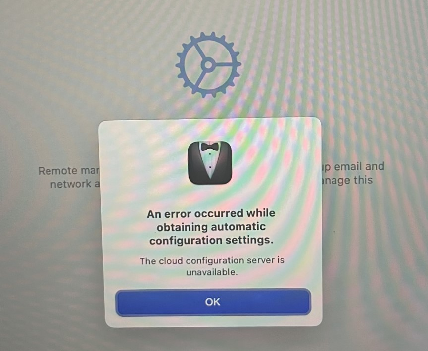

I've read a previous post that stated to reset the PRAM/NVRAM, which did not work. Here's the error:
Things we have tried.
  • Reset NVRAM/PRAM
  • Un-assigned from ABM then Re-assiged. Once completed, renewed the DEP token
  • Enabled Debug Mode,  replicated the issue for about 15-20 minutes. Disabled debug mode and then download the Jamf Pro Server log. Uploaded to Jamf support case
  • Jamf support stated there was an APNs mismatch, but we confirmed afterwards there was not.
  • Ran First-Aid within macOS Recovery
  • Fully wiped the disk and cleanly installed macOS
  • In Jamf Pro, un-assigned the machine from PreStage, save changes, wait 10-15 minutes and then assigned it back.
  • Jamf support is now trying to say it's an issue with Apple and to contact Apple.
Not sure what to do at this point, but I'd appreciate any help.

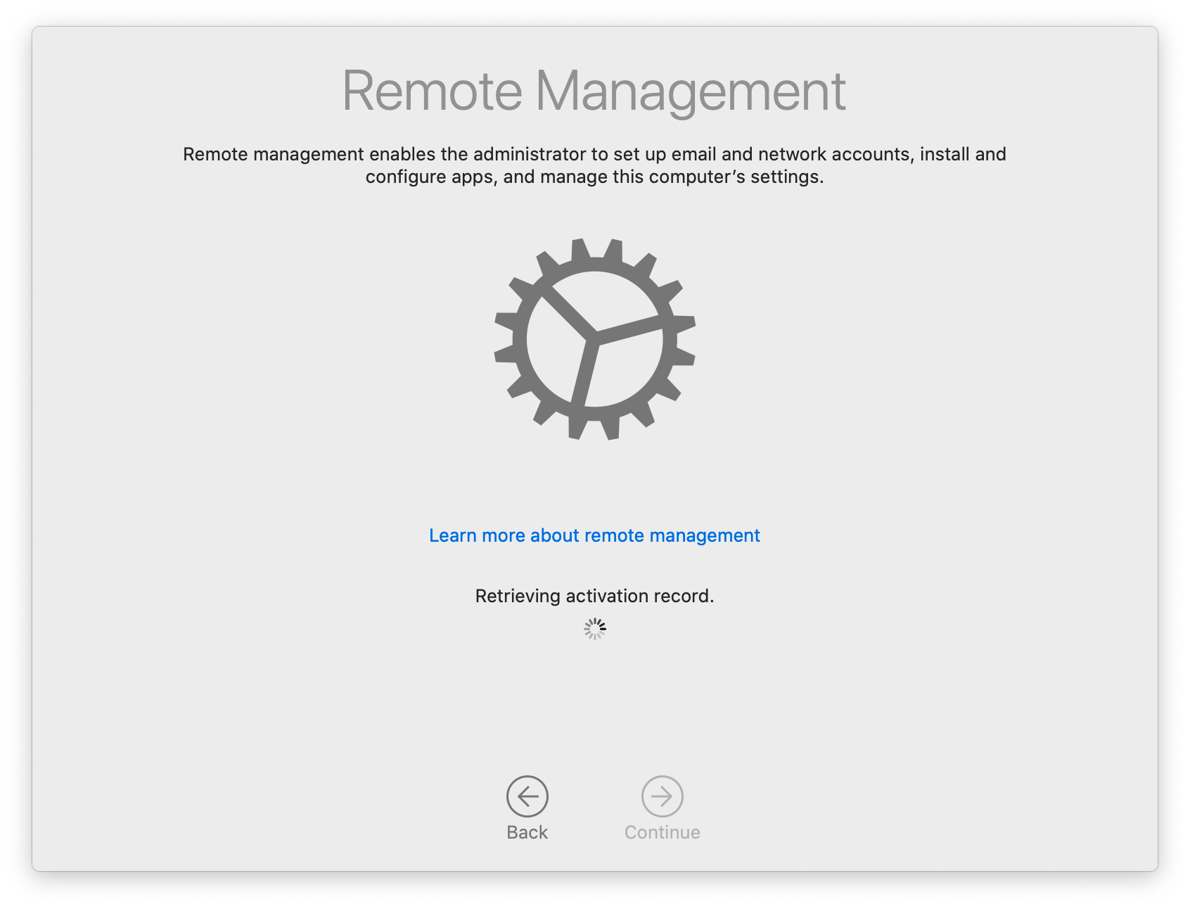

Not sure why that was accepted as a solution. But this didn't work. I completely removed the MacBook from ABM, which also removed it from the Jamf PreStage. I then tried to erase and reinstall macOS, but upon the setup, it takes me to a Remote Management screen like this:
At this point, I'm going to try the DFU fix, where you can Revive/Restore the device via Apple Configurator.
