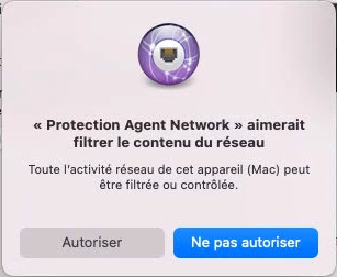

However, the antivirus still requires an additional authorization (Content Filter):
I did not find this information. For other antiviruses yes, not for Panda. Is it possible to authorize this on a computer and then retrieve the necessary informations with a command line?

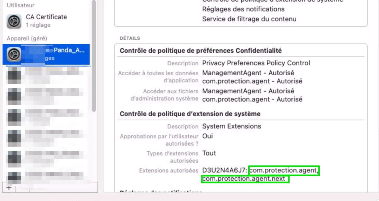

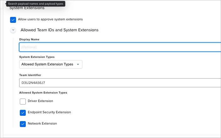

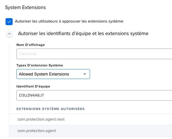

System extension is setup :
On Jamf :
On computer :
On computer (verify) :
If I click on the button Open Security Preferences panel button (first screenshot on my forst post), I See :
It's Content Filter the "problem".

do you not need to add this?
  • May 24, 2023 8:50 AM UTC
They are already added in Jamf :
