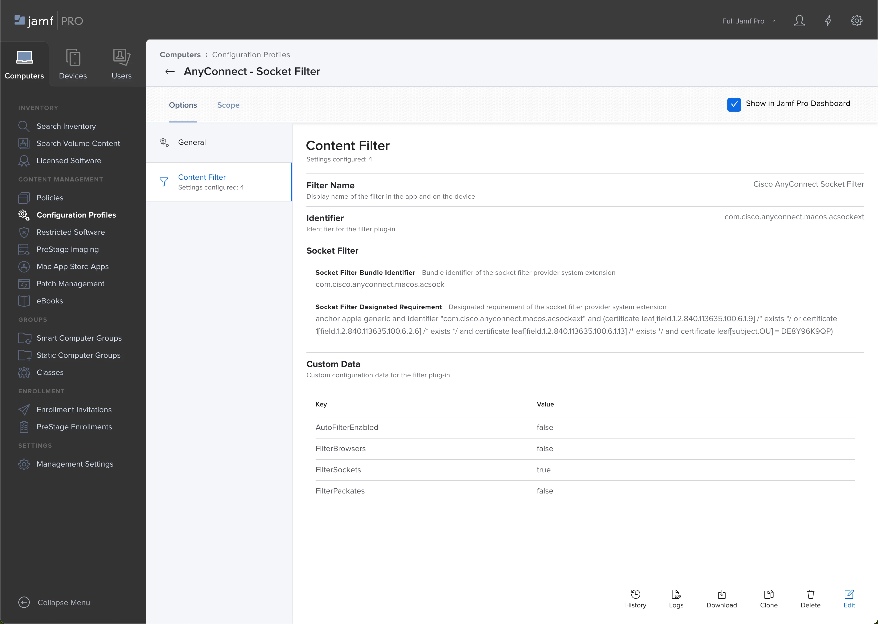

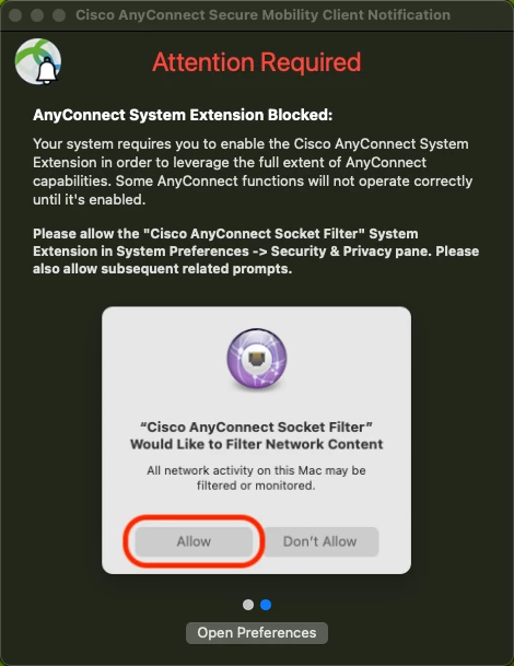

AJPinto

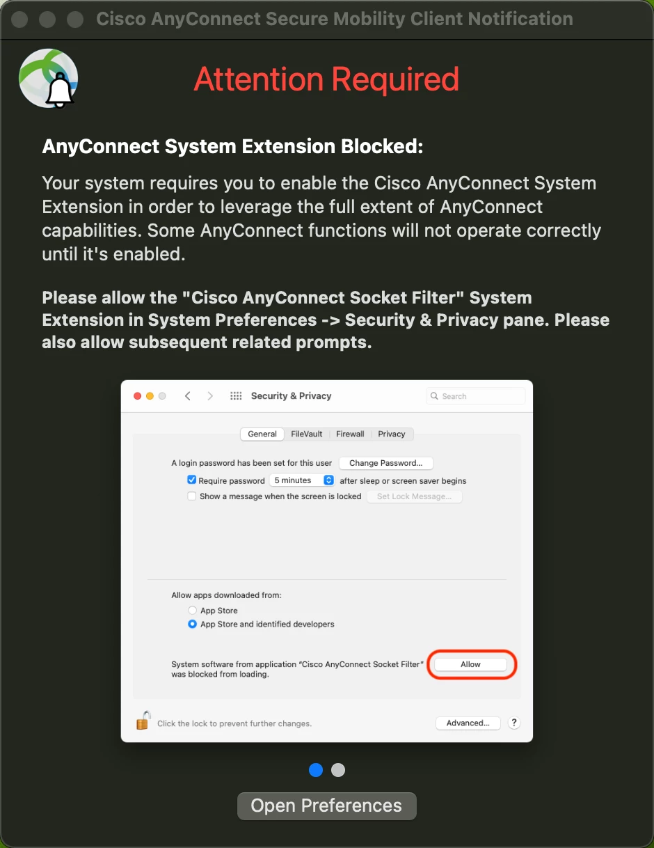

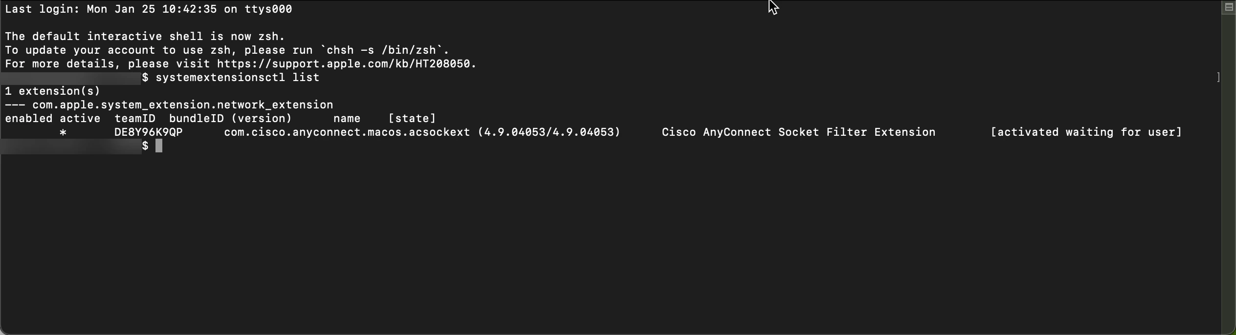

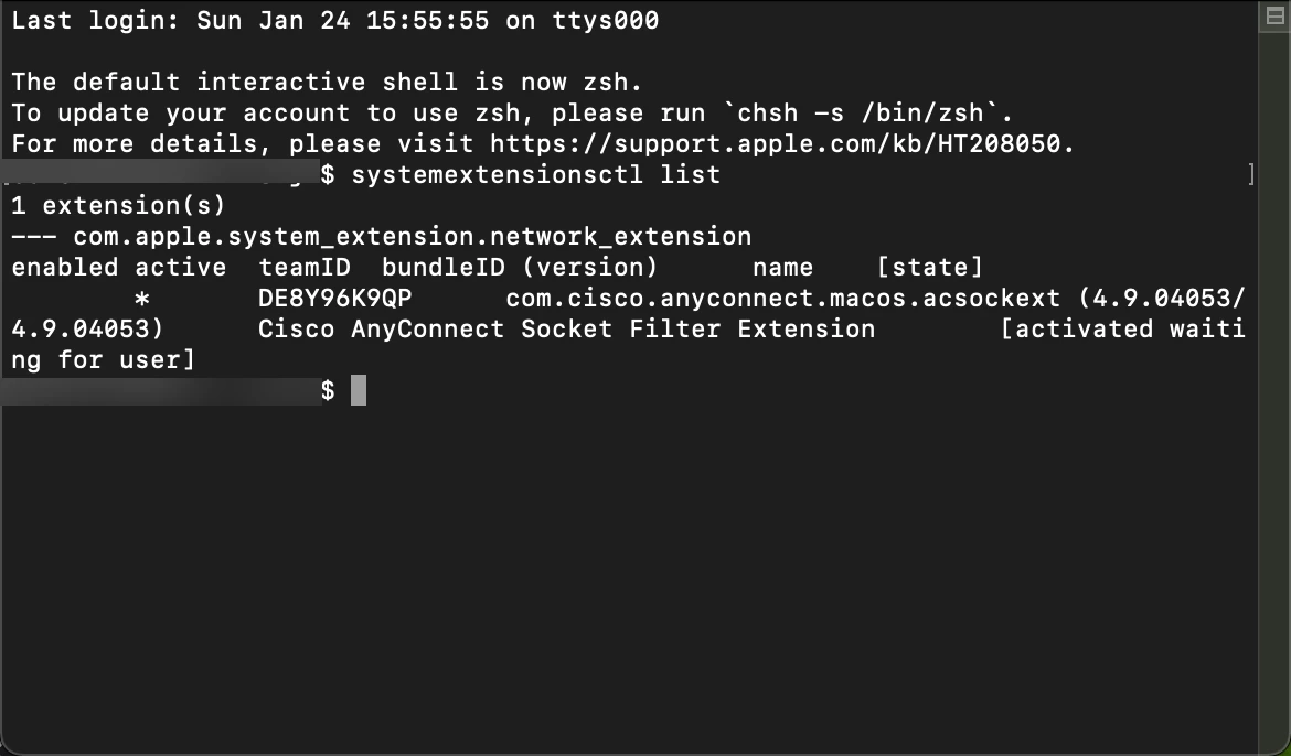

I have seen several discussions on this topic but so far following them I have not been able to get rid of the Cisco AnyConnect Socket Filter PPPC pop. I have a few configuration profiles for AnyConnect following other people and Ciscos generic documentation and it looks like they have installed correctly. However the popup persists. Anyone got any ideas?

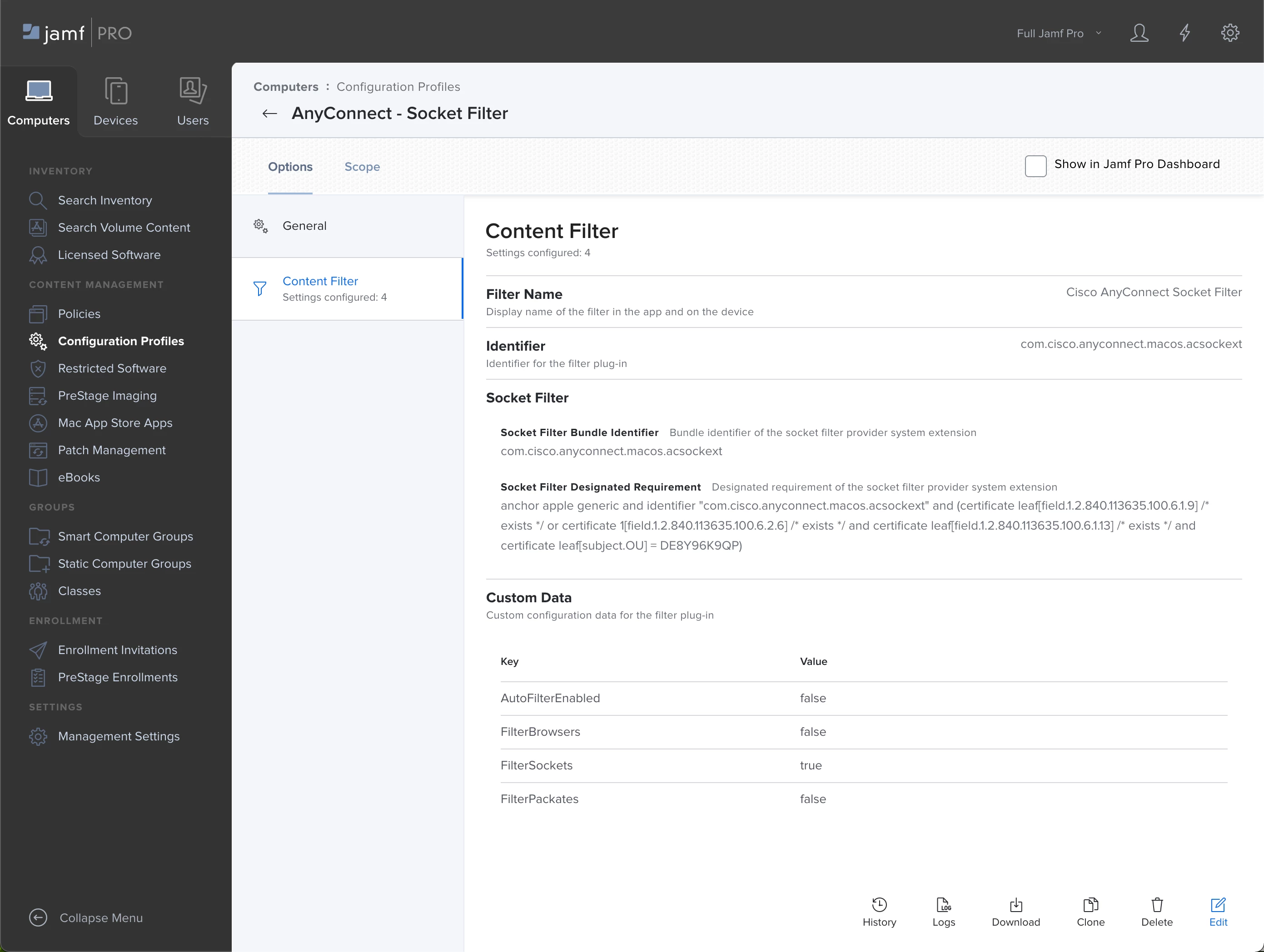

It looks like you have a typo in the Socket Filter Bundle Identifier. It should be com.cisco.anyconnect.macos.acsock. Try changing that and see if makes any difference.
AJPinto
  • Jan 25, 2021 5:16 PM UTC
@RBlount I fixed that but it still wont move past "activated waiting for user". I copy pasted Socket Filter Designated Requirement so that should be right.

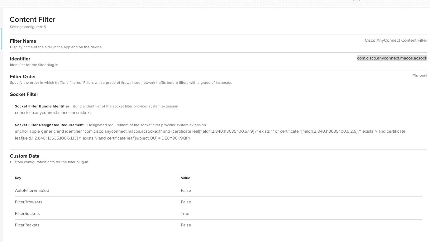

roiegat
  • Jan 28, 2021 5:25 PM UTC
only difference I can see is that in our identifier its: com.cisco.anyconnect.macos.acsock
Attaching our info.
Mark_Lamont
  • Mar 24, 2021 2:35 PM UTC
there is a difference, filter Order is set.

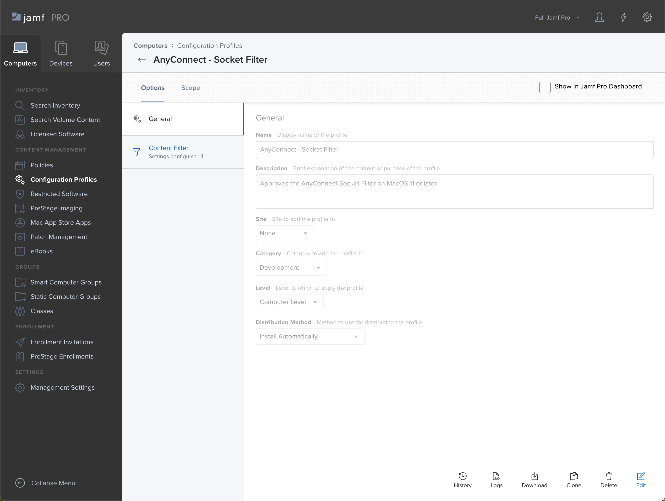

  • Mar 24, 2021 3:06 PM UTC
Is the System Extension in a different config profile? Probably need both to get it approved without user interaction.

we're experiencing similar issues. I went through and changed per the suggestions above, but still doesn't seem to want to enable it automatically (still prompting the user).
I also went through this KB article and at the bottom is the text for their premade mobileconfig, which I put into jamf and it still prompting.
  • Jun 12, 2021 10:23 AM UTC
Deleting these worked for me. AnyConnect still works fine.
/Library/LaunchAgents/com.cisco.anyconnect.vpnagent.plist /Library/LaunchDaemons/com.cisco.anyconnect.gui.plist /Library/LaunchAgents/com.cisco.anyconnect.notification.plist
You might be able to get away with deleting just the last one, though.
EDIT: Confirmed that this is the only one you need to delete:

  • Jan 11, 2024 1:41 AM UTC
Is there an equivalent elegant way to stop the popup notification for Cisco Secure Client v5.1.x.x?  The command
rm -f /Library/LaunchAgents/com.cisco.anyconnect.gui.plist
no longer works as that file is no longer there to delete.  I do have an alternative method.
rm -rf /opt/cisco/secureclient/bin/Cisco\\ Secure\\ Client\\ -\\ Notification.app
  Deleting the notification app works, but it seems so brute-forced.
