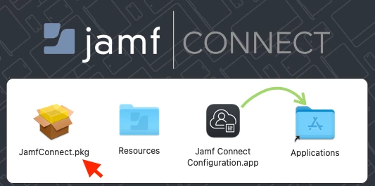

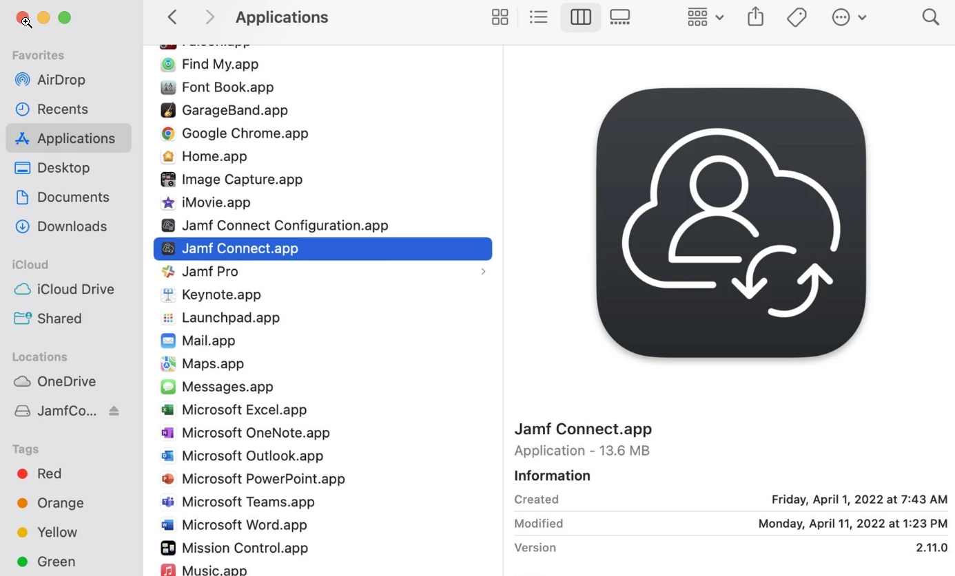

anyone can help me out on jamf connect from 2.11 to 2.12
  • May 9, 2022
  • 12 replies
  • 67 views
I know this properly very easy to do, but i pretty new on the jamf . if anyone can assist that would be very appreciated!

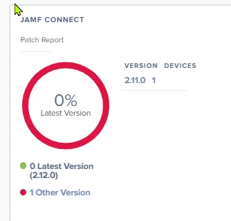

we have patch management setup by jamf trainer that we setup earlier, it shows below and remind me to update the package.

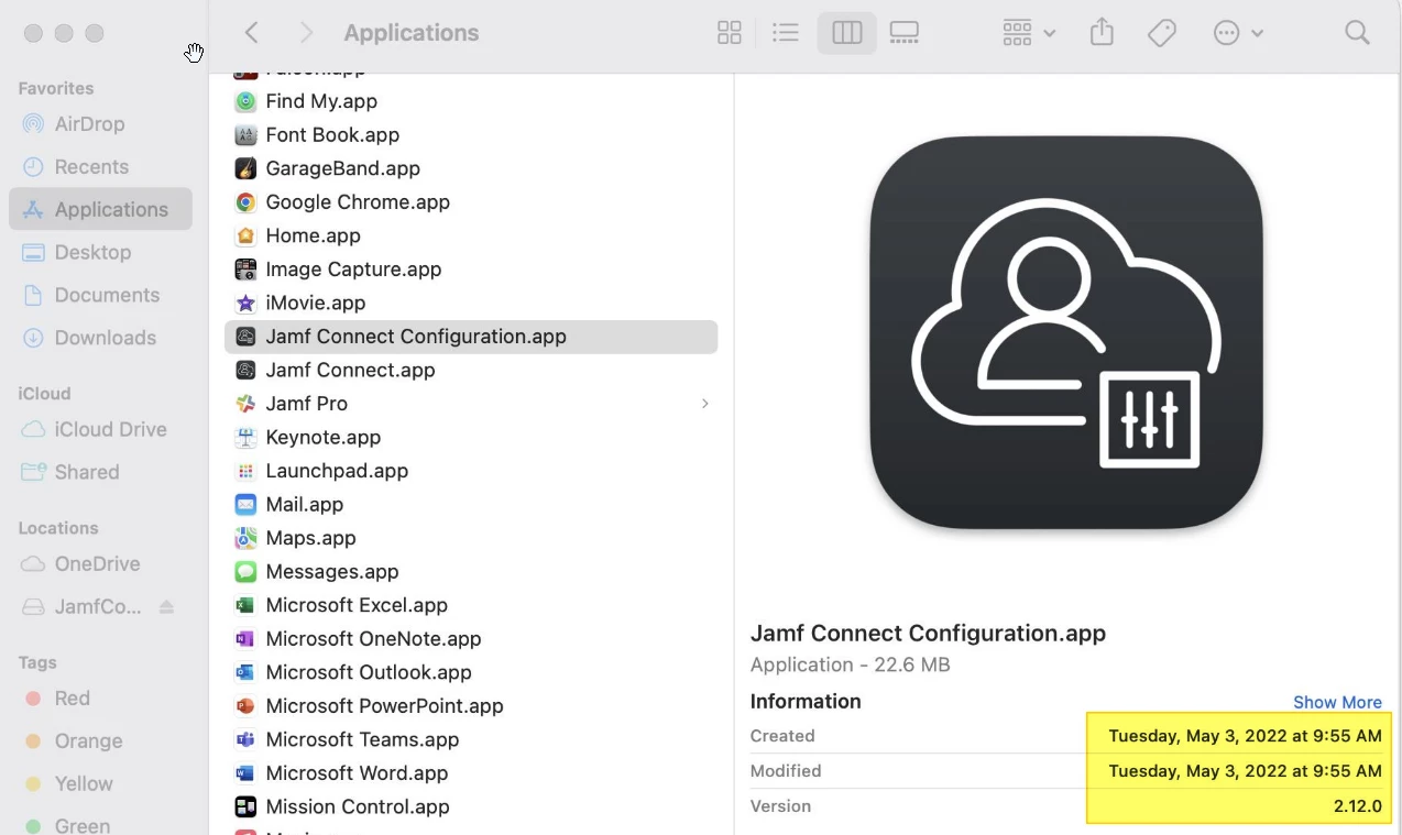

I have downloaded the latest dmg form jamf account , i mount it and put the "jamf connect configuration.app" to the application folder .  one of the jamf connect updated, but the other still 2.12. same with the patch management too. please advise.

I don't see you mention installing the JamfConnect.pkg. Jamf Connect Configuration is for the admin, not for everyone.
For deployment, we use Jamf Connect built-in Deployment and Update which can be found in Jamf Applications. We don't care to keep it up-to-date, usually skip several versions.

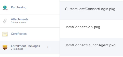

If I'm not mistaken, the packages should be the JamfConnect and LaunchAgent. Some organization have additional package with their own logos and wallpapers to customize the Login screen and Menu Bar icon. You should be able to find them in "Packages" under "Computer Management".
These packages are part of our Pre-Stage Enrollments "Enrollment Packages" instead of policies. But if you're certain they created policies, then they should be there unless someone deleted them. If you have a device already went through the process, you can check that device's Management > Policies, and see which policies they have.
We don't touch the deployment packages, so they're older version. We have the Jamf Connect update settings to update them (my previous screenshot).

1. yes, 3 package are currently under packages  ( jamfconnect.pkg ; jamfconnect -graphic.pkg; jamfconnectlaunchagent.pkg ) [just don't know how they make the jamfconnect-graphic.pkg or where to get this file]
2. true, we jsut launch jamf from our enviroment , so we created on both ( one for exiting device, other is for pre-stage enrollment)

Did they create the jamfconnect-graphic.pkg on your computer? If so, probably in folder usr/local/jamfconnect-graphic. Otherwise, you'll have to create that again. The package has to be signed though. Follow the instruction HERE. You also can find folder on any newly enrolled device.
Follow THIS to create the .pkg. Keep the logos and background with the same name as before, or you'll have to edit the Jamf Connect plist...

You don't need to run the command. Just go to the Pre-Stage Enrollment and replace the graphic .pkg under Enrollment Packages GUIDE
We don't use policy for Jamf Connect, I can't help you with that. Maybe someone else knows more.
