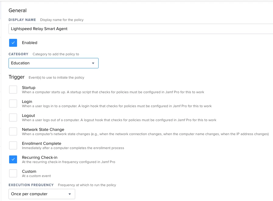

After we prepared the package and started test deploying it to some spare Mac OSX computers we found that some of them were reporting properly and some weren't. The problem was two fold:
The first issue was that we had the policy in JAMF set to run on Login, Logout, and Recurring Check-In. If the Relay Smart Agent package tried to install via Login/Logout, it would complete and apply the filter correctly, but the reporting side of things didn't work. When we signed in as a user it would log them simply as "base." This appeared to be a generic account that Relay would use to record all the usage logs for every computer that it didn't recognize, with no way of differentiating between them. After some more testing we found out that our Relay policy had to be set with ONLY the Recurring Check-In flag in order to install and then report properly. Anything else would nullify the reporting aspect.
The second issue was that the Relay Smart Agent requires a kernel extension to be approved for reporting to work. Since our student laptops were on varying versions of 10.13, some of them would auto approve this extension and some of them would manually require approval in Security & Privacy, which obviously no student is going to do. Our version of JAMF at the time didn't have the approved kernel extension functionality, so we had to upgrade. Once we did and once we added Relay as an approved extension, it retroactively allowed the kext on all the machines that it was pending on and they started reporting properly.

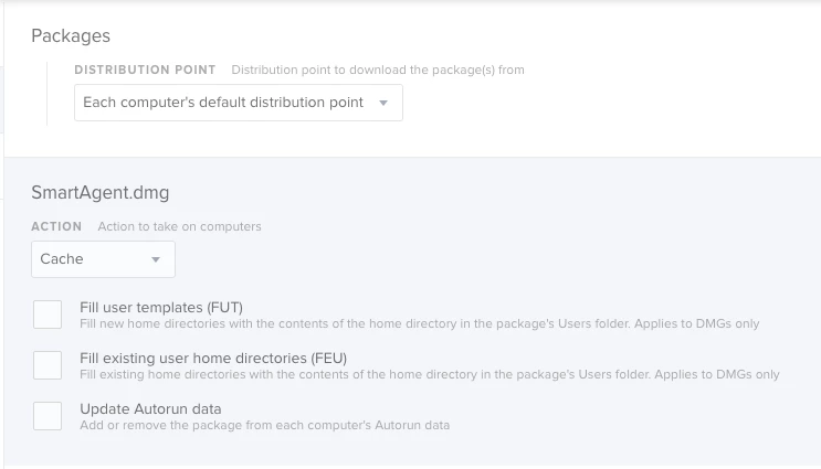

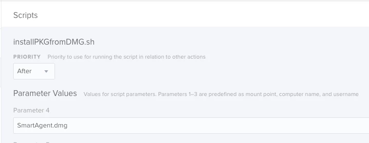

@dwaterbury You dont need to repackage the SmartAgent.dmg. After downloading the agent from relay.school, just upload it straight to Jamf Admin, then use the Jamf provided script here installPKGfromDMG see the below screenshot of the policy.
