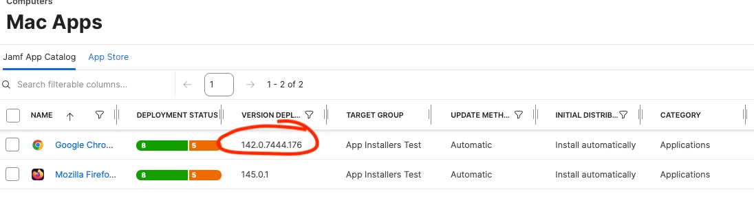

When I checked the version of Chrome, it has updated and is now 142.0.7444.176 (Official Build) (arm64) which matches the version in the App Installers
I struggled to find a log on the Mac,  However, there is an item under Jamf Pro → Device → History → Management History on the server and that has an entry
InstallEnterpriseApplication - Google Chrome - 142.0.7444.176 18/11/2025 at 10:29 AM
Which is a week ago not 24/11/2025 when I had the message
So, I’m confused.  Why the error message about the failure?  What was the failure?  How can I find out what it was?  Can I suppress messages like this?

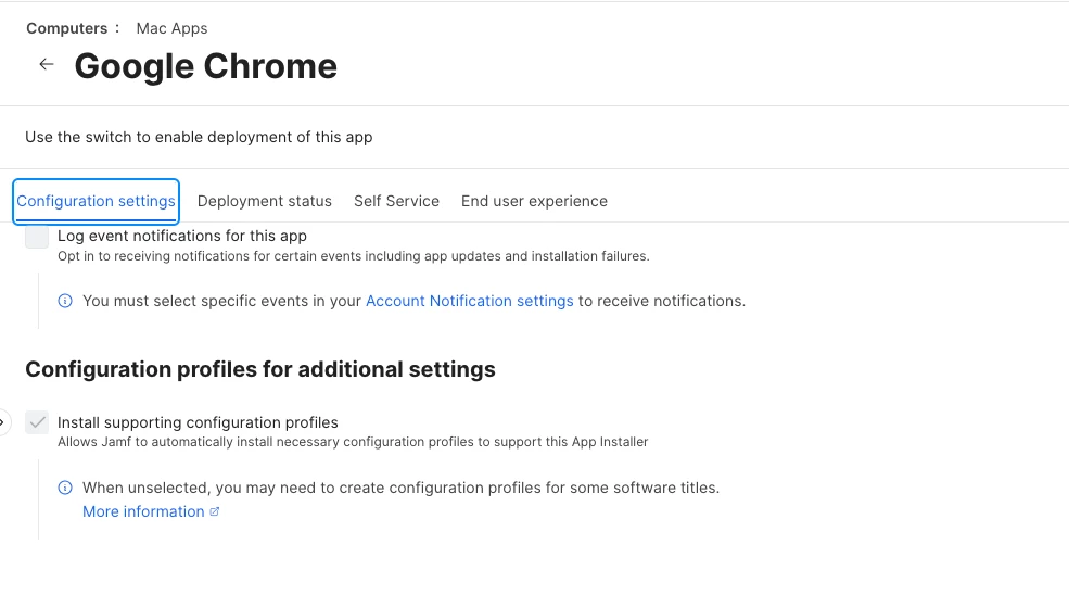

Best answer by dlondon
Hi ​@Chubs
Well I feel really bad.  It’s looking like the error message was because I didn’t tick the box “Install supporting configuration profiles”
I had been doing some testing and forgot I left it unticked
On the bright side I learned a whole lot about the process and the one place to find a log :)

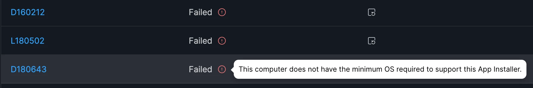

I’d always recommended to use the updater for the app itself.  E.g.: Google has their Chrome Enterprise Core tenant (free) that works great for updating Google Chrome (not to mention a plethora of other things that come baked in).
Now to say this - there are some level of logs on the app installer as to why it’s failing (queue the little “!” beside the failed ones):

Thanks for that ​@Chubs
Where do you see that log info?  I’m not seeing any failure In the App Installer Area that looks like what you are displaying.  In fact I have no failures listed there at all just “Installed” and “In Progress”

Apologies if I’ve chopped off something but looking in the install.log is new to me

Well I think install.log on 18th showed that it found a version difference and so installed 142.0.7444.176
What isn’t clear (to me) is why it ran again on the 24th.  It did however detect that the installed version and the version to be installed were the same so failed
2025-11-24 10:06:19+08 dep59767 Jamf App Installers[55143]: Google Chrome 142.0.7444.176: Pre-install check failed: Bundle version does not match the one in the plan: /Applications/Google Chrome.app.

Hi ​@Chubs

​@dlondon this is not a requirement for the app to function properly - we have all of ours unchecked namely to not turn off the updater features of the app.
