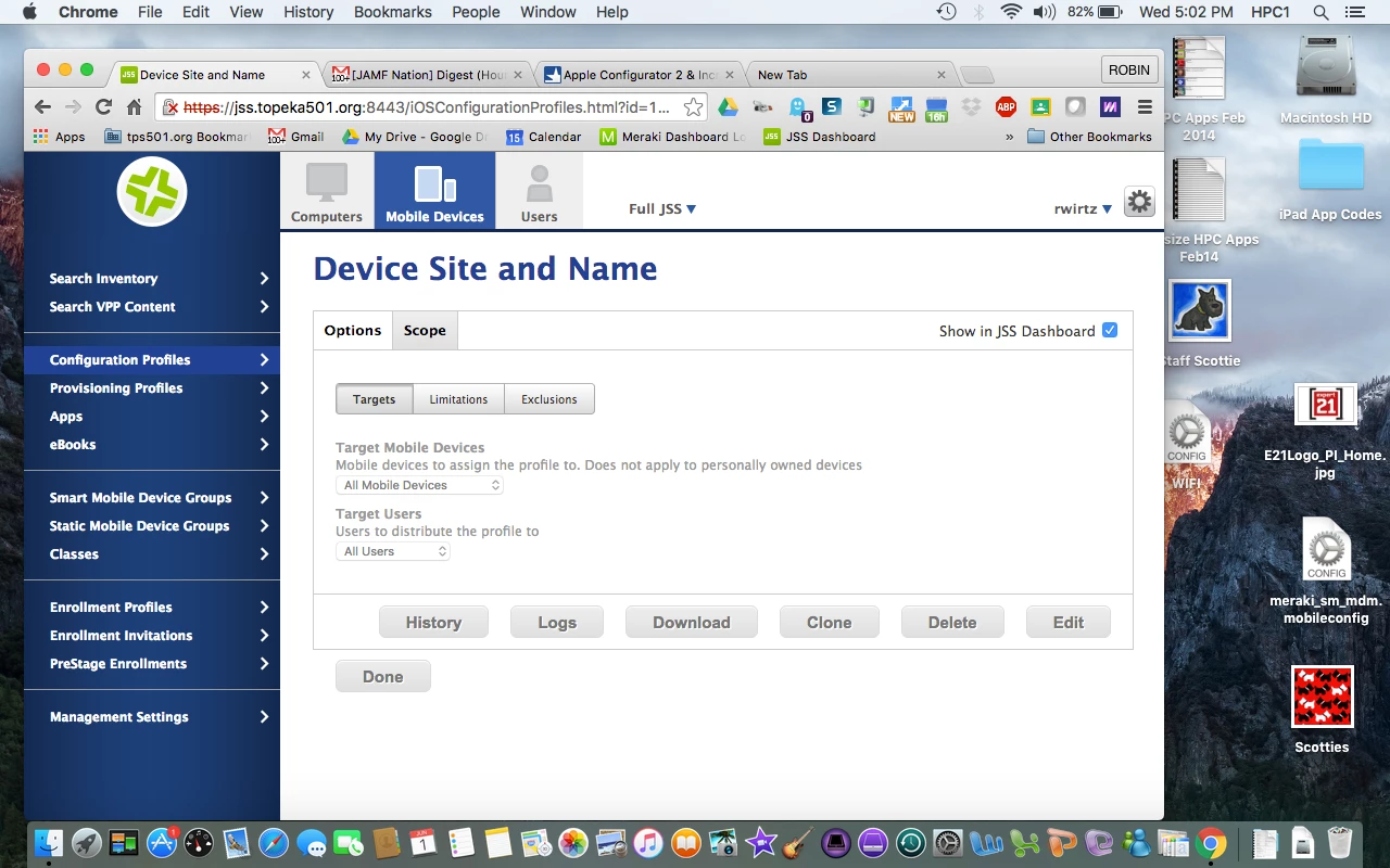

[http://docs.jamfsoftware.com/9.91/casper-suite/administrator-guide/iOS_Configuration_Profiles.html]
I'm not sure what to do about the AC 2 naming problem but this is how we get the name and fixed asset to show on the front screen of mobile devices in JSS. We use a "Device Site and Name" configuration profile. After we rename or enroll devices we always click "apply to all". This may not be anything at all what your looking for but hopefully it can help somebody.
