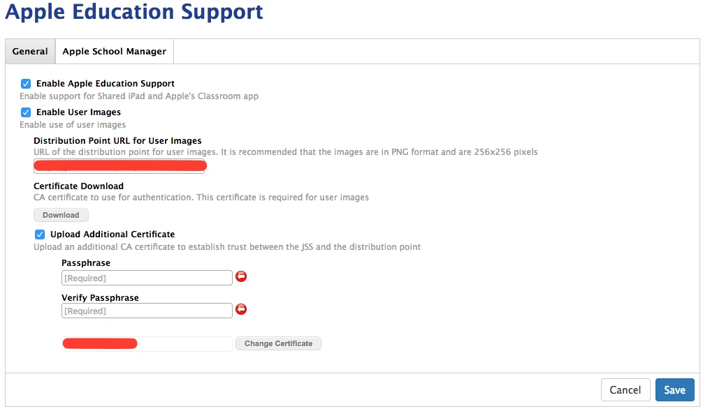

Can anyone shed some light on what I need to do when it comes to the 'Certificate Download' and 'Upload Additional Certificate' options?
I've went thorough all the docs I can find and the most helpful line is this:
"save the certificate in the appropriate location dictated by your web server vendor."
That just doesn't help me much.

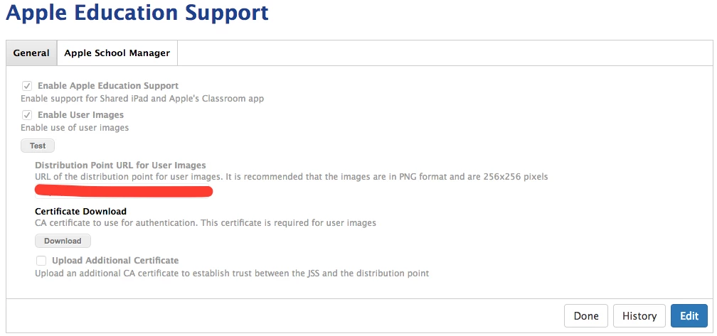

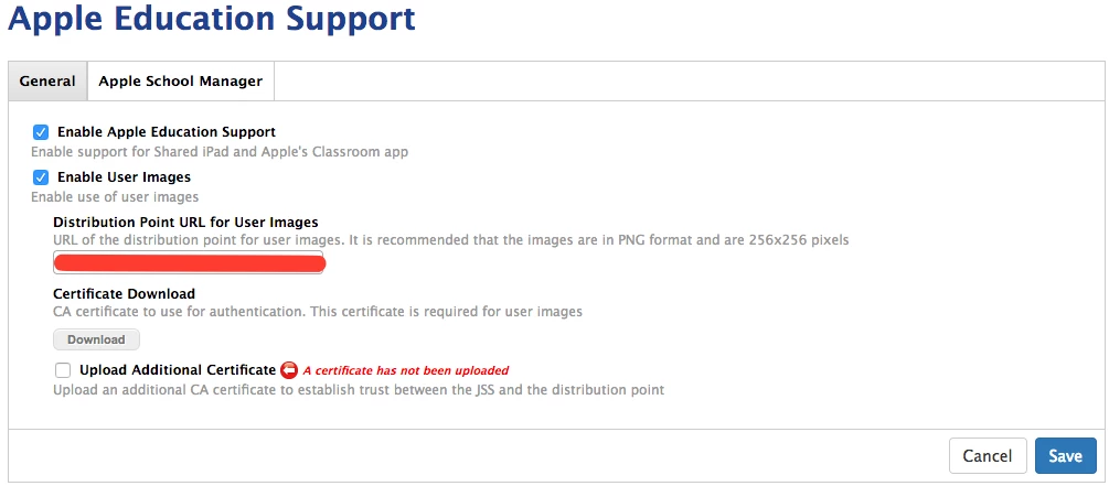

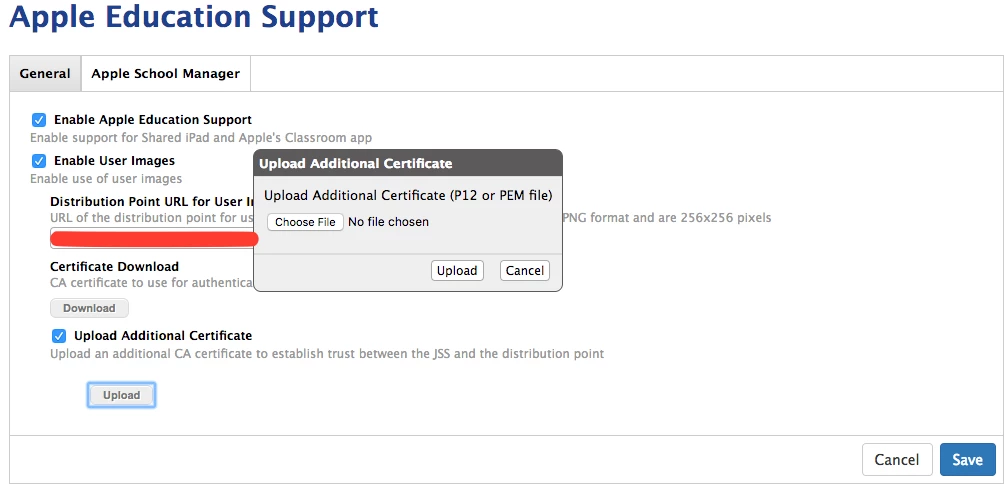

I have our images on an apache2 web server and they working correctly using SSL. They are accessible inside our network and out. When I attempt to add our wildcard certificate as the 'Additional Certificate', I get a message that it has not been uploaded. You can see the process in the pics.
Does anyone had more detailed information on what to do with the certificate I get from the Download button and what certificate to upload as an Additional Certificate?

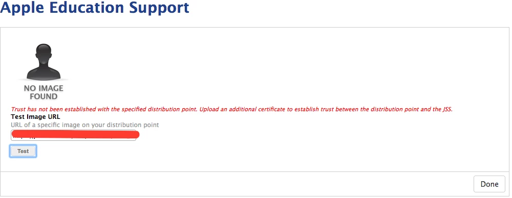

When I use the test button and use a valid url to a user image, I get this:

Unfortunately, this process has helped us discover a problem in our DB that is preventing us from uploading certificates, and therefore causing us to get the errors in the pics above.
  • Feb 24, 2017 7:12 PM UTC
IIRC, there was an issue with uploading a .cer. The fix was renaming the .cer to .der to get it uploaded, not sure if it's relevant here, but worth a try
  • Feb 24, 2017 7:16 PM UTC
@LSinNY, I gave it a try, but the upload box only accepts pem or p12. Thanks for the idea though. :)
  • Mar 23, 2017 2:44 PM UTC
To wrap up our issue, we found that a chrome extension was preventing us from performing certain actions on the JSS's webpages, including uploading the certs. Once we had the extension problem under control, we could get back to configuring the web server to host the images. While the JAMF photo server doc [https://drive.google.com/open?id=0B1G0Rt4a6S4vTldNQ1JRWkVzaE0](link URL) was extremely helpful, we are using haproxy for load balancing so we had to do things a little different to get it working on that server. Here's the instructions for the haproxy configuration : [https://drive.google.com/open?id=1O_gXyCguULy6Qw_oBA7glhkyQgDOGX4ljaOTqHEzXwA](link URL)
