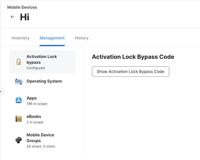

1. We apply the rule when restoring a Mac you must log out of iCloud and find my Mac,

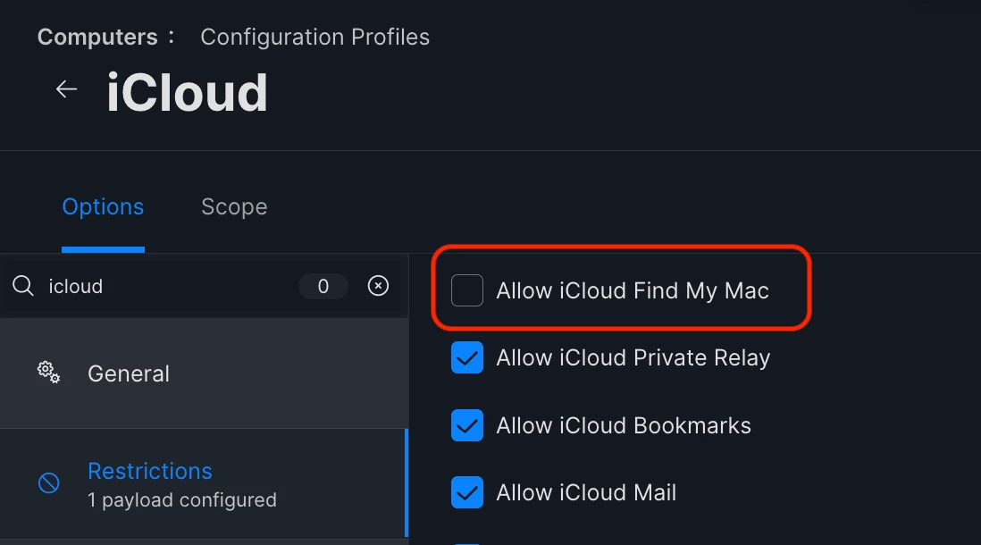

2. Disable iCloud find my Mac from Jamf configuration profile , to prevent User from activating Find My Mac .
3. If your Mac is locked with Find My Mac/iCloud, you can unlock it with the activation code from Jamf.
Find the activation code in:
Mobile Device > Management > Activation Lock Bypass Code

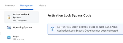

Note: Supervised: Yes – If the device is not supervised, the Activation Lock Bypass Code will not be available.
For devices locked with Find My, first, restore the device. In the password section, copy and paste the activation code (ensure the device is connected to the internet).
Here are some references you can read before proceeding with the restore process.
https://learn.jamf.com/en-US/bundle/jamf-now-documentation/page/Using_Activation_Lock_Bypass.html
https://it-training.apple.com/tutorials/deployment/dm265/

@YLIL In addition to the suggestions from @agungsujiwo you should also make sure that you have the "Prevent user from enabling Activation Lock" option enabled in your PreStage enrollment. That only applies if you're using Automated Device Enrollment to enroll your Macs in Jamf Pro, and if you're not you really should look into it.
