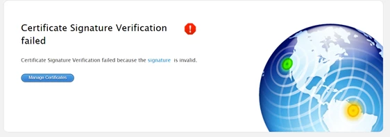

Hi All,
When I try to update the push notification I get this error anyone has any idea why I'm getting this?
Didn't change anything in my server except to update the server from 2012 R2 to R2019. That was the only change I did for my server.
When I Download the signed CSR from Jamf Nation and upload it to the Apple push certificate portal I get this error.
Thanks

Getting exact same error here.
  • June 2, 2023
I'm getting this error as well, our JAMF is in the cloud.

Running into the same issue, on both our Dev instance and Prod - Are we thinking this is a JAMF-side issue or Apple?
